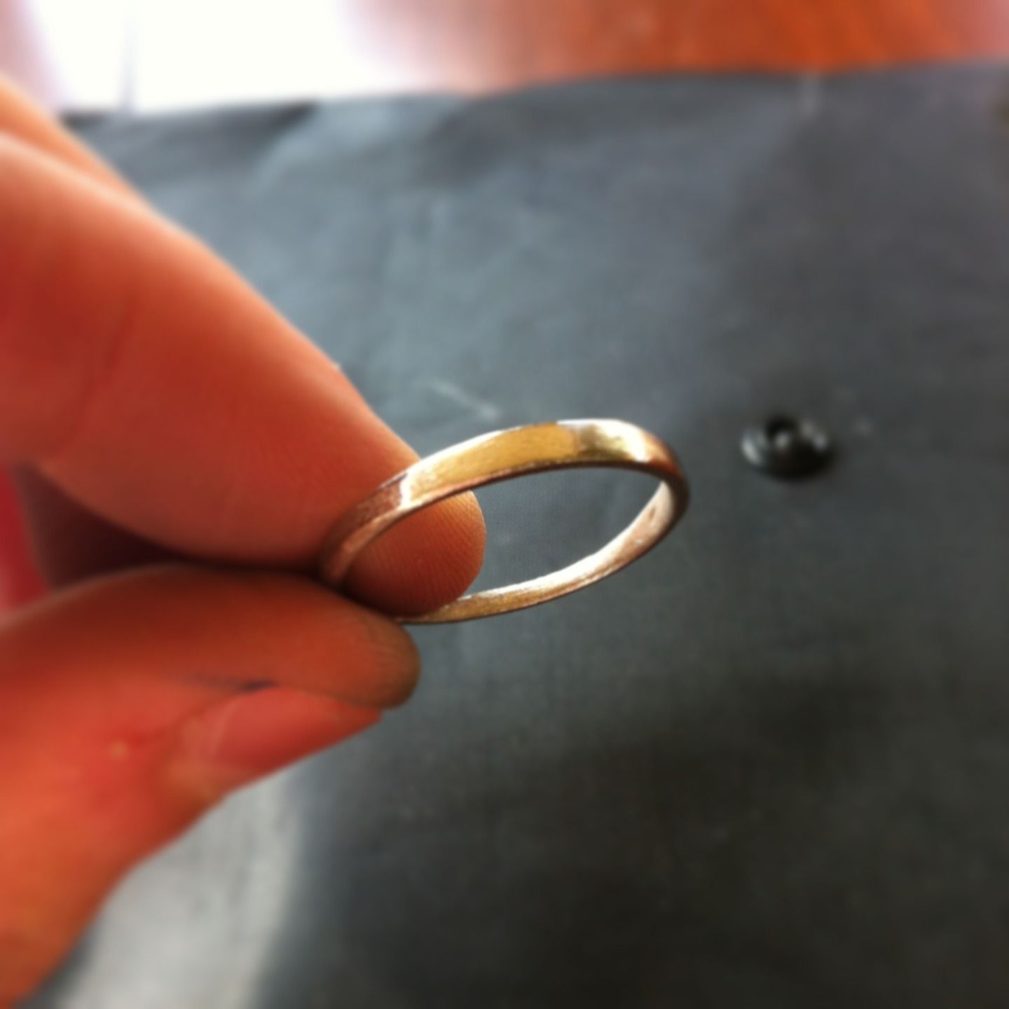

Step 5: You're Done!
Pat yourself on the back and admire your beautiful ring! you most likely did this in one sitting, there was sweat, possibly blood.. Some nasty words after hitting your finger with the hammer... -_- but it was worth every second, to see the finished product!
