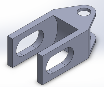

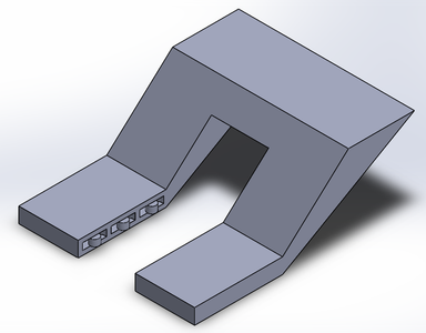

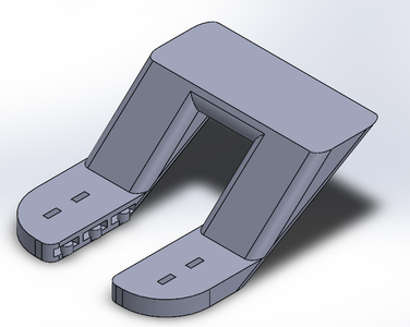

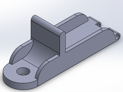

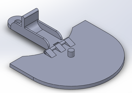

I started with a sketch on how i would want it to work. Each link will be made of 2 parts where at one end we allow rotation in one axis and at the other end rotation in a perpendicular axis.
I name the part that will contact the ground as "Main Plate" and the part that allows for the additional flexibility is named "Pivot Plate"

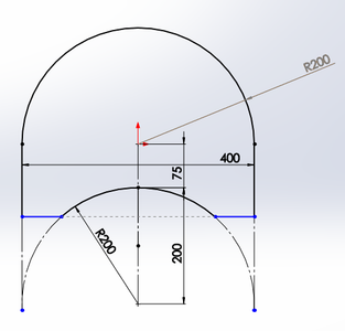

The main plate will need to be able to pivot around adjacent main plates while maximizing contact with the ground. To achieve this, a semicircle is used for the front. To ensure that the adjacent main plate pivots correctly, the pivot should be located at the center of the circle. At the back, I made a "chopped off" semi circle, chopping off the tail allows it to turn properly (refer to picture).
As for the pivot plate, since it is closer to the "wheels" than the main plate is, it is also the pivot plate's job to allow for some interface that allows power to be transmitted to the tracks. The pivot plate is also going to have some interfacing surface with the guide rollers that we will cover later. The pivot plate is basically has one end that allows a main plate to rotate about an axis and another end that allows the next main plate to rotate about a perpendicular axis. It also has a large protrusion that allows the drive cog to engage it and turn the track, much like rack and pinion gears.

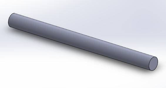

I also made a pin just to hold it together. But in hindsight, we can probably omit this pin to allow for faster computation in the motion analysis (will be covered later) since the mates defined will be sufficient

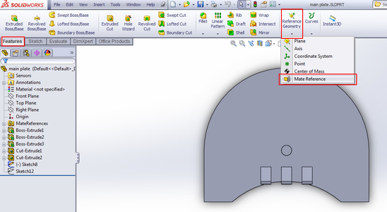

Initially I assembled one link (main plate+pivot plate+pin) and saved it as a separate file then I tried to assemble multiples of it together. The results were not satisfactory as I could assemble the track, but it could not rotate.
In order to assemble the track to the desired length quickly, I used mate references instead. Mate reference allows the parts to "snap together" when you hold them close together in assembly.
How to set up mate reference
  1. Open the first component/part file.
  2. Select "Mate reference", Found in Features>Reference Geometry>Mate Reference
  3. First name the Mate reference. *Important* make sure it is exactly the same as its counterpart in the next component.
  4. Next is to select the desired surface or edge or point and the desired mate type (default is ok, but not always the best) If you use surface or edge, you will usually need more than one mate reference, ensure the order of primary, secondary and tertiary mates are the same for its counterpart.
  5. Open the next component/part file.
  6. Repeat steps 2,3 and 4
  7. Repeat for as many components and mate reference you need.
Once you have your mate references set up, when you open the parts in an assembly file, they should snap together and automatically generate the desired mates when you bring them close together.

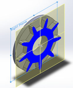

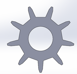

Step 3: Designing the Drive Cog/wheel

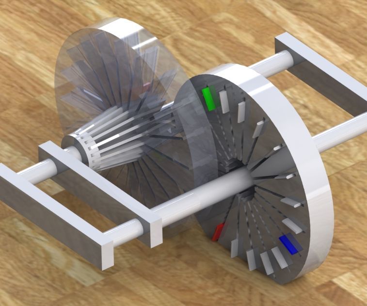

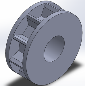

I am not sure what the correct term is, so forgive me please. Here its more of a story of failure, the few initial iterations did not work properly when tested with the motion analysis. So why would you bother to read about my failures? so you don't repeat them.
In the initial design, I positioned the tracks into a semi circle, drew a circle, drew lines from the center of the circle to the pivot plate protrusions and measured the angle of these lines. I then made the wheel and cut out narrow slits for the protrusions to interface with. The problem is that the spacing between the protrusions are very large unlike conventional tracked vehicles, this made it quite unreliable from the test i did.
Next I tried widening the slots and later i tried adding more slots but to no avail. Finally I took a different approach and instead of a solid block with slots, I made a Yo-Yo like wheel with plates.
To be honest, it works but its very poorly designed and I am not very satisfied with it. However it works well enough for a concept.
*The drive wheel could also use heavy trimming to reduce weight and material cost.

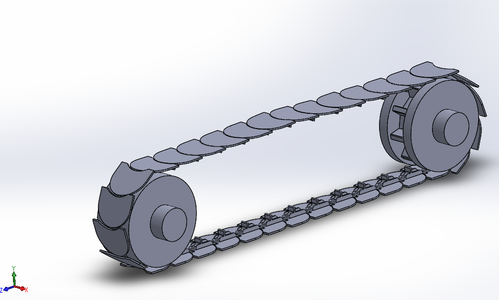

To ensure the track maintains its shape for operation, we need another wheel in front and a way to hold both of the wheels.
The design of the front wheel is pretty straightforward. The front wheel can be exactly the same as the drive wheel as some vehicle (some tractors) are 4WD. Here I used a YO-YO shaped wheel similar to the drive wheel but without the interfacing plates, this was done mainly to cut down on computational time.

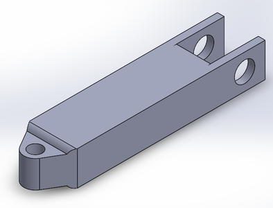

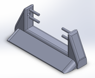

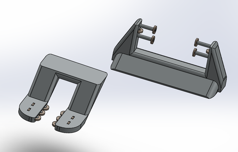

The structure holding the wheels are a little more complicated. We will need to ensure that we are still able to steer the track since thats the whole point of this project. Also keep in mind, we will need some way to maintain tension on the track when the track is steered. Remember the hypotenuse of a triangle is always shorter than the sum of the other 2 sides.
There are many was to achieve this, here is what i did.
The rear bracket is "fixed" as in it will be attached to the vehicle chassis or will be the chassis and it is the reference point for all other parts. (The universe revolves around the rear bracket!!). The rear bracket simply holds the rear axle in place and provides pivot for the front bracket. The front bracket has a point that pivots about the rear bracket and a slot that holds the front axle. The front axle is held in a slot so we can place springs that act to maintain the track in tension.
In hindsight, for a design made to be retrofitted to 4WD vehicles, tension of the track should probably be maintained using a mechanism similar to a bicycle chain tensioner. If the front wheel is also a drive wheel for a non-single-track-vehicle, the vehicle's front axle should enter from the pivot and power the track's front axle through a gear system.
The rear bracket is very basic and can be modified. Some of the possible modifications:
  1. Made into just a frame that can be bolted onto a vehicles chassis for retrofit
  2. Made to hold additional idlers and suspension
  3. Made to hold flexible guides that can "shape" the way the track interfaces with the ground. (more on this later)
  4. Made into the chassis of a single track vehicle. (You can put your rider on top or even inside! but not under)

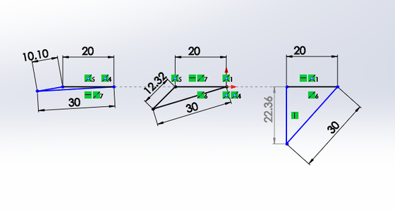

The main purpose of the track guides are to ensure that the track will bend where you want it, how you want it. The design of the guides are very straightforward, it is basically something that holds a couple of rollers that restrict the tracks motion in certain directions (translational and/or rotational)
For the top guide, you mainly want the track to bend at the pivot, this is because it allows for the smallest footprint and would not allow the track to "cut into" the vehicle's body when steering, this also ensures that the tracks engage the wheels straight on and would be less likely to fall off. One of the simulations i performed without the guides actually saw the tracks fly off.
For the bottom guide, having the track bend at the pivot should allow for the best possible steering at the cost of some ground damage but I may be wrong as its a deduction based on intuition. You can and maybe should have multiple instances of the bottom guide modified to accommodate suspension springs and dampers. The bottom guide may also be used to "shape" the track into a smoother curve instead of an abrupt bend.
