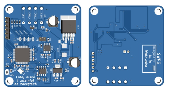

The Steering Wheel Position Sensor is a crucial component utilized to measure the angular position of the steering wheel. Its primary function is to provide information regarding the steering wheel's position upon starting the vehicle. This data is essential for calibrating the steering system.
The board is built around STM32L4P5RET6 MCU. A 5V buck converter powers it. The position of the steering wheel is measured using a Hall-effect AS5601 sensor. The chip is a magnetic rotary position sensor designed for precise angle measurements. It offers high resolution with a satisfactory resolution of 12 bits, making it suitable for accurately tracking rotational positions. The chip operates contactless, ensuring durability and reliable performance while providing configurable options for integration into various systems.
The data is sent to the main computing device via the CAN interface. In our car, the CAN is utilized for communication between components. The Steering Wheel Position Sensor (SWPS) transmits the current steering wheel position and diagnostic data over the CAN bus. This allows for real-time monitoring of the steering wheel position.

Step 2: PCB
PCB Layout
