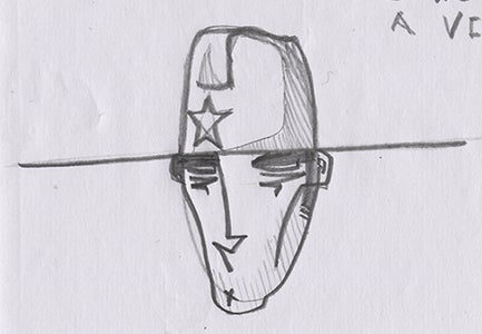

Step 1: Step 2 - Drawing the Project
If you cannot draw find a logo or a drawing which you like and digitize it:

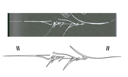

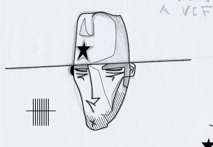

Step 2: Step 2 - Vectorise!
With Illustrator vectorise your drawing so as to be able to select thereafter the various parts of the layout:
Step 3: Step 3 - Other Part
For this example I also digitized and vectorized a kind of tag (it is written sheriff, I were young at the time...):

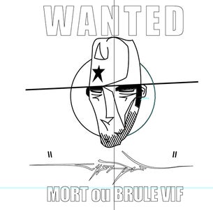

Step 4: Step 4 - Page Setting
Choose a page-setting on your A4 format of the various elements of the stencil key set.
Here a little text, a circle behind the character and two drawings vectorize
(the text means something like "Wanted Dead or Burned alive", i repeat i was young):

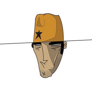

Step 5: Step 5 (optional) - Choosing the Colors
Export quickly made your drawing is made a small search for colors.
Here 7 colors on the final one;
4 for the caracter (2 colors on dark and light version)
1 for the bottom of the circle
1 for the bottom of the A4 format
and finally black for the features and the text
