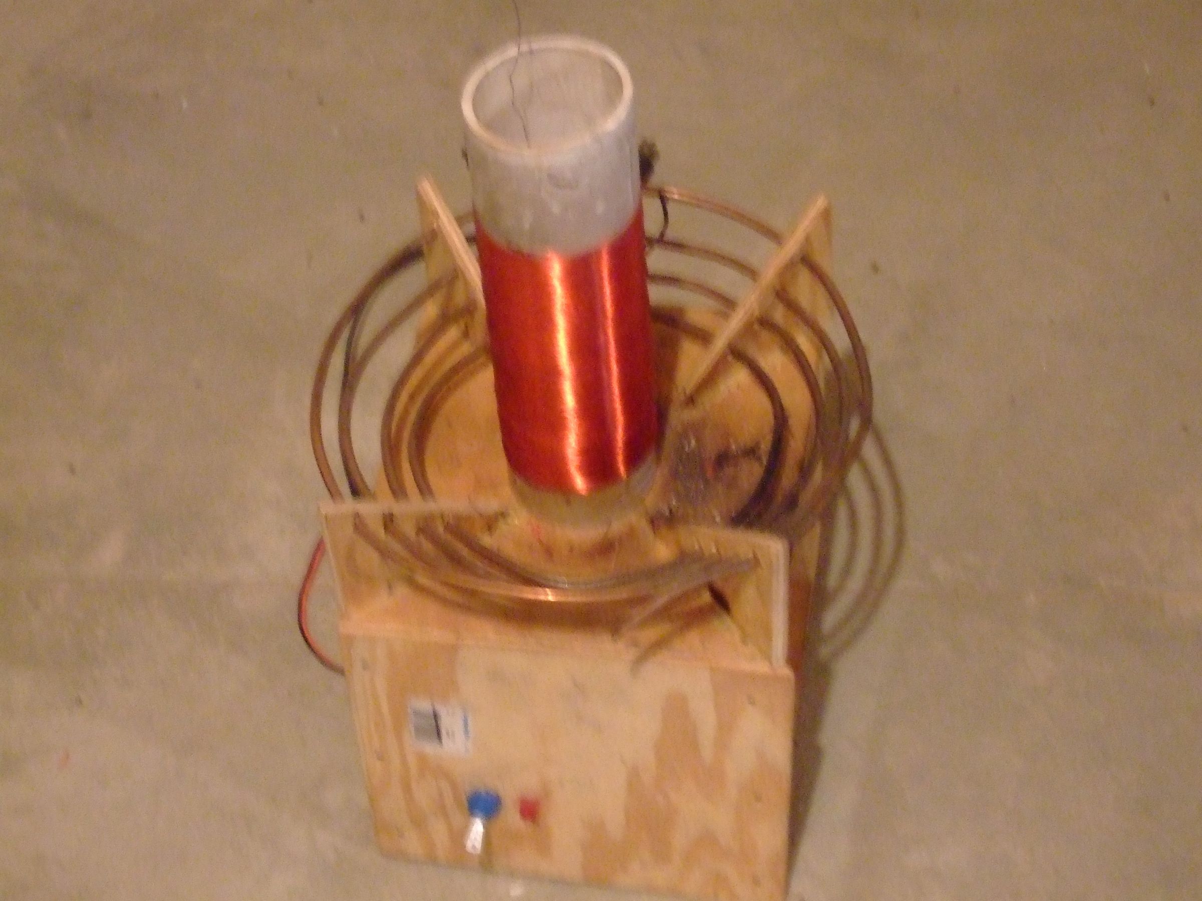

Step 3: Making the Secondary Coil.
Supplies Needed:
1. PVC Pipe
2. 24-26 AWG Magnet Wire
3. Masking Tape
4. Wire Cutters
5. Drill
6. 1/8 Drill Bit
7. Safety Glasses
1. Get your 3 foot long 5-6 inches in diameter PVC pipe.
2. Get your enameled wire
3. Next drill 3 holes in the side of the bottom of the PVC pipe (about 1-2 inches above the bottom and a 1/4 inch along the bottom of the PVC pipe. this will hold the wire that is wrapped around the PVC pipe.
you will have to make these holes about 2 inches below the top of the PVC pipe and 1/4 inch apart make sure that the wire comes out of the end of the PVC pipe.
4. Next insert the wire through one of the end holes that you drilled and weave it through the other 2 holes (make sure that some of the wire comes out of the bottom of the PVC pipe.
5. Next you will have to get some tape: Masking tape, Electrical tape, Vinyl tape, or Packaging tape will work.
6. Next wrap the wire around the PVC pipe making sure that the wire will not overlap or have kinks or bends in it because this will greatly reduce the amount of voltage that your Tesla Coil will produce. also (make sure that the wire is tightly wound and tightly close together when wound.
IF YOU GET TIRED OF WRAPPING THE WIRE YOU WILL USE THE TAPE FOR HOLDING THE WIRE IN PLACE SO IT DOES NOT UNRAVEL.
7. You will have about 1000-3000 wrappings of magnet wire after you are finished.
after you are finished wrapping the PVC pipe with wire. just put that aside but make sure you have thread the wire through the last 3 holes a the top of the PVC pipe. and put tape over both three holes where the wire in located this will hold the wire in place until later.

Step 4: Making the Primary Coil.
next you will need the copper tubing the copper tubing will serve as your primary coil.
you will first have wind about 20 feet of the copper tubing in a helix or in a flat spiral form making sure not to let any of the other coilings touch each other because this will cause a short circuit.

Step 7: Adding the Toriod or Topload
Parts you will need:
1. Toroid
2. Secondary Coil
The Toroid is the top load of the Tesla Coil it is where the arcs form.
To connect the Toroid to the Tesla Coil just put the wire that is hanging from the top of the Tesla Coil in the Toroid by either soldering, brazing, or with a screw.
Then fasten the Toroid to the Secondary Coil
You are finished with your new companion.
