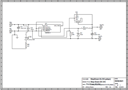

The intention of this circuit is to encourage DIY because we know we can find identical models ready to buy. This circuit is based on the LM2596S IC. We can energize the circuit with voltages from 4VDC to 40VDC and in its output we can obtain from 1.5VDC to 35VDC with current up to 3 amps, controlling the output voltage by potentiometer.

Step 3: Schematics
