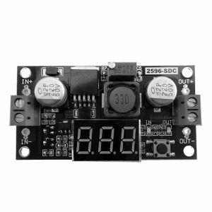

Step 1: The LM2596 DC-DC Buck Step Down Converter Module
A finished LM2596 step down module you can get from about 4 €.
The LED voltmeter makes the voltage setting very comfortable. With the trim potentiometer accurate adjustment is possible.
The operation of LED's must not be exceeded the allowable current. Furthermore, the LED should do not heat above 80 degrees.
The most important data:
Input voltage range: 4-40 v (40 v to limit the highest voltage).
Output voltage range: 1.25V - 37V (decompression mode, input output must be greater than 2 V above).
Output current: 2 A continuous outputs.
Output power: the maximum 15 w.
Grain wave peak: 100 mv.
Voltmeter precision: ± 5 ‰ .
Static power: 20 ma
Weight: 33g.
Button to switch measurement of the input or output voltage and LED indicates the current measurement of the input or output voltage.
Continuously adjustable output voltage range of 1.25V -37V, 4-40V input voltage range.
The input voltage is at least high than the output voltage of 1.5V?.
