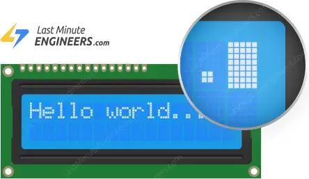

Character LCD Display
True to its name, these LCDs excel in presenting characters. For instance, a 16×2 character LCD can exhibit 32 ASCII characters spread across two rows.
On close inspection, you’ll notice small rectangles for each character on the screen, along with the pixels forming a character. Each of these rectangles forms a grid of 5×8 pixels.

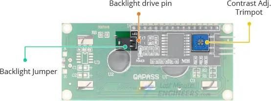

I2C LCD Adapter
The core of the adapter features an 8-bit I/O expander chip – PCF8574. This chip transforms the I2C data from an Arduino into the parallel data necessary for an LCD display.
The board is equipped with a small trimpot for precise adjustments to the display’s contrast.
A jumper on the board supplies power to the backlight. To regulate the backlight’s intensity, you can remove the jumper and apply external voltage to the header pin labeled ‘LED.’

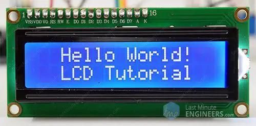

Step 4: Simple Arduino Sketch – Hello World
The provided test sketch will display ‘Hello World!’ on the first line of the LCD and ‘LCD Tutorial’ on the second line.
Prior to uploading the sketch, a minor modification is required to ensure its functionality for your setup. You need to specify the I2C address of your LCD, along with the display dimensions, in the LiquidCrystal_I2C constructor. If you’re utilizing a 16×2 character LCD, input 16 and 2; for a 20×4 character LCD, input 20 and 4.
#include <LiquidCrystal_I2C.h>
LiquidCrystal_I2C lcd(0x3F,16,2); // set the LCD address to 0x3F for a 16 chars and 2 line display
void setup() {
lcd.init();
lcd.clear();
lcd.backlight(); // Make sure backlight is on
// Print a message on both lines of the LCD.
lcd.setCursor(2,0); //Set cursor to character 2 on line 0
lcd.print("Hello world!");
lcd.setCursor(2,1); //Move cursor to character 2 on line 1
lcd.print("LCD Tutorial");

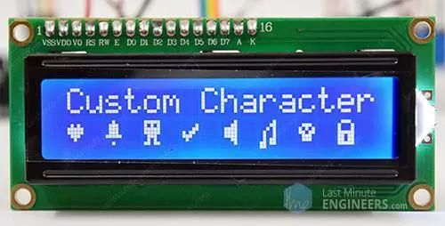

Step 5: Arduino Example Code
The sketch below demonstrates how to display custom characters on the LCD.

// Clears the LCD screen
lcd.clear();
// Print a message to the lcd.
lcd.print("Custom Character");
// Print All the custom characters
void loop()
lcd.setCursor(0, 1);
lcd.write(0);
lcd.setCursor(2, 1);
lcd.write(1);
lcd.setCursor(4, 1);
lcd.write(2);
lcd.setCursor(6, 1);
lcd.write(3);
lcd.setCursor(8, 1);
lcd.write(4);
lcd.setCursor(10, 1);
lcd.write(5);
lcd.setCursor(12, 1);
lcd.write(6);
lcd.setCursor(14, 1);
lcd.write(7);
