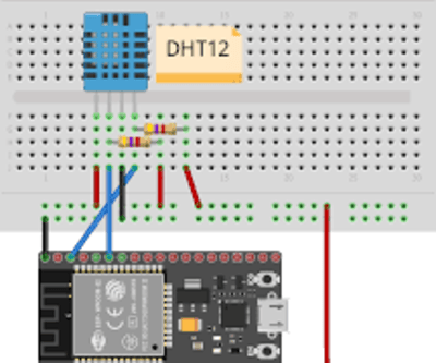

Step 1: Wiring the Components
Soil Moisture Sensor to ESP32:
  1. A0 (Analog Output) → ESP32 GPIO36.
  2. VCC → 3.3V pin on ESP32.
  3. GND → GND pin on ESP32.
Relay to ESP32:
  1. IN (Signal) → ESP32 GPIO25.
  4. NO (Normally Open) and COM (Common) → Connect to the water pump circuit.
Water Pump:
  1. Connect pump power supply to the relay’s NO and COM terminals.
Tubing and Drip Emitters:
  1. Arrange tubing around plants and install drip emitters at the base of each plant.
