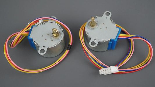

The accompanying image showcases a pair of 28BYJ-48 stepper motors.
Stepper motors encompass internal coils that induce stepwise motion of the motor shaft in either direction when electric current is applied to the coils in a defined manner.

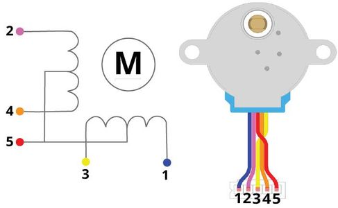

The 28BYJ-48 stepper motor comprises four coils in total. These coils are linked at one end to the motor’s red wire, connected to a 5V source. The opposite ends of these coils correspond to wires tinted in blue, pink, yellow, and orange. Activating the coils sequentially generates a step-by-step motion of the motor in either direction.
In half-step mode, the 28BYJ-48 Stepper Motor upholds a stride angle of 5.625°/64. This translates to the requirement of 64 steps (360º/5.625º = 64 steps) to complete a full revolution in half-step mode. When operating in full-step mode, this count decreases to 32 steps, resulting in one complete rotation.
However, an integral gear ratio of 64:1 influences the output shaft. This implies that for every 64 revolutions executed by the internal motor, the external shaft accomplishes a single revolution. Consequently, the motor must execute 32×64 = 2048 steps to realize a full rotation of the external shaft. This level of precision corresponds to a step angle of 360º/2048 steps = 0.18º/step.

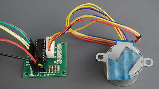

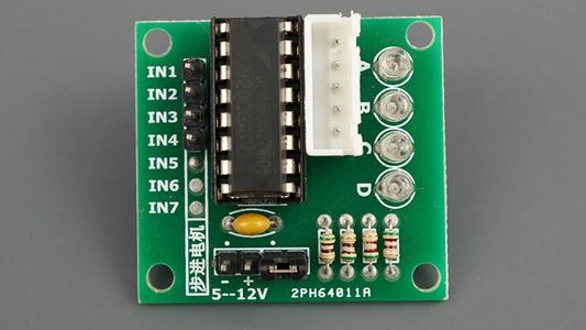

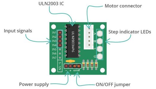

To establish a connection between the ESP8266 NodeMCU board and the stepper motor, we will employ the ULN2003 motor driver, depicted in the diagram below. Notably, the 28BYJ-48 stepper motor is frequently bundled with the ULN2003 motor driver.
This module features a convenient connector that simplifies the process of linking the motor to the module. The module incorporates four input pins dedicated to controlling the coils responsible for the stepper motor’s motion. Additionally, the inclusion of four LEDs offers a visual representation of the coils’ operational status.
The module includes pins designated for connecting VCC and GND, alongside a jumper cap that functions as an ON/OFF switch for powering the stepper motor. Removing the jumper effectively cuts off power supply to the motor. For those desiring manual control, these pins can serve as connections for a physical switch.

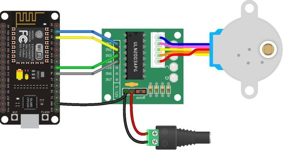

Step 4: Wire Stepper Motor to the ESP8266 Board
This section outlines the steps to connect the stepper motor to the ESP8266 using the ULN2003 motor driver.
To achieve this, we will link IN1, IN2, IN3, and IN4 to GPIO pins 5, 4, 14, and 12 respectively. If needed, you have the flexibility to choose other appropriate digital pins by referring to our ESP8266 pinout reference guide.
For a clearer understanding of the process, please refer to the schematic diagram provided below.
