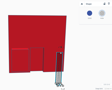

Step 8: Adding a Bay Window to Your House.
The block needs to be 36mm off the floor against the front of the house.
Step 9: Adding a Bay Window
Change the size of the window to 28mm x 15mm x 45mm
Step 10: Adding a Bay Window
Hit your arrow keys and check the window connects to the building. Insert a wedge shape and rotate it.

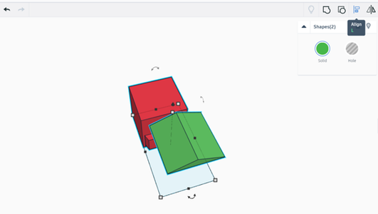

Step 14: Creating the Roof
Add a roof shape size 110mm x 110mm x 20mm
Step 15: Aligning the Roof
Align the roof centrally on both sides. Then click your arrow key 5 times to move it back 5mm
Step 16: Completed Main Body of the House.
Rotate and check that all parts are grouped and aligned correctly.

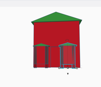

Step 17: Creating the Bay Window Roof
Add a roof and resize it – 14mm x 35mm x 5mm
Move the window 45mm off the ground.
Step 18: Creating the Bay Window
Step 19: Duplicating Bay Windows
Copy the windows and align them moving the arrow keys on your keyboard.
Step 20: Duplicating Bay Windows
Do this until you have four windows. You should drag the upper windows upwards using the black triangular arrow.
