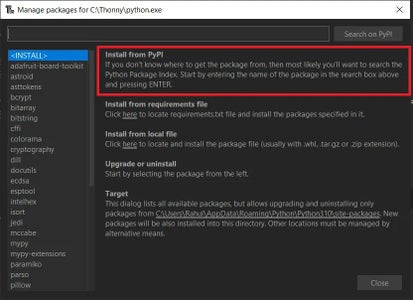

If you are using thonny ,You can also use the built in package manager present in the Thonny IDE to install the ttkbootstrap library.

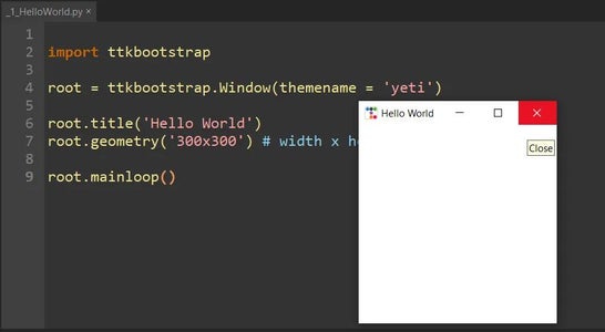

Please type the following code into the text editor or IDE like Thonny.
You can now run the code by pressing F5 on Thonny IDE or by using the Python interpretor.

The above code begins by importing the ttkbootstrap library, which provides themes for Tkinter-based applications.
It then creates a window using the ttkbootstrap.Window() function, specifying the "yeti" theme to give the window a sleek, modern look.
The root.title() function is used to set the window’s title to "Hello World," which will appear at the top of the window.
Next, the root.geometry() function defines the window’s dimensions, setting it to 300 pixels wide and 300 pixels high.
Finally, root.mainloop() starts the Tkinter event loop, which is necessary to keep the window open and responsive to user interactions until it is closed.
The root.mainloop() method begins an infinite loop that listens for events, such as user inputs (like clicks, typing, or window resizing), and continuously updates the window based on those events. It ensures that the window remains open, responsive, and interactive until the user closes it. Without this call, the window would open briefly and then close immediately because the program would finish executing without entering into the loop that handles user interactions
