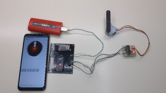

Introduction: Stepper Motor Control X Bluetooth and App
About: Hello, my name is Carlos. I have a YouTube channel where I share my projects in https://www.youtube.com/c/carlosvolt
In this tutorial we will see a circuit, which controls a stepper motor, with an application made in app inventor, using bluetooth, and the hc-05 module and arduino.
Step 1:

Application
Download app and source file app inventor–> app bluetooth stepper motor
