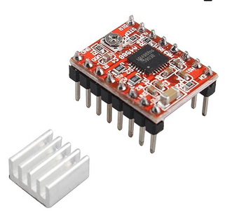

  • Arduino Uno or Mega 2560
  • A4988 Stepper Motor controller or compatible.

As shown in above image, the A4988 or similar device interfaces between the microcontroller - in our case an Arduino Uno or Mega 2560 - and the stepper motor.

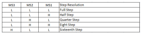

The most important A4988 inputs:
  • MS1 ... MS3: select the step size (full, 1/2, 1/4,... 1/16th of a step). See above image
  • DIR: motor direction (application specific).
  • STEP: for every rising edge, an "MSx" controlled step is generated on the motor coils (ex. 1/4th step).
The Outputs OUT1A/B and OUT2A/B drive the two motor coils.

stepMotor?SetStepMode (MOTORSTEPSELECTION sl)
Step Selection can be any of the step sizes supported by the A4988.
  • MOTORSTEP_FULL
  • MOTORSTEP_HALF
  • MOTORSTEP_QUARTER
  • MOTORSTEP_EIGHT
  • MOTORSTEP_SIXTEENTH
Writes the desired mode to the A4988_x_MS1 /2/3 pins. The return parameter is (signed) char: any negative value is an error, zero means no error. Positive is used as indicator. The A4988 pins are only driven when defined. If the driver has no access to these A4988 MSx pins, the user is responsible to hard-wire these A4988 pins and only select the modes that matches the hardware configuration.
