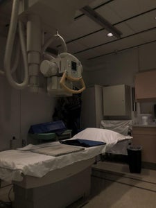

  1. After a radiographer reviews the schedule, they make their way to the imaging department to prepare for their shift.
  2. Before coming in contact with any patients, they need to make sure the room is clean and organized. This primarily includes cleaning the x-ray table, changing the pillowcases, and properly examining all the needed equipment to make sure it is operating properly.
  3. They also need to make sure the equipment is properly calibrated while following safety standards. Maintaining a clean environment contributes to patient safety by reducing the risk of infection for patients undergoing imaging procedures.

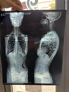

  1. To properly position a patient for an X-ray, it is important to understand both posterior-anterior and lateral positions. They are defined as directional terms used in anatomy and certain healthcare positions to describe the location of different body parts from the front, back, and sides.
  2. Anterior refers to the front of the body, posterior refers to the back of the body, lateral refers to the side of the body away from the midline, and the opposite of lateral refers to the side of the body towards the midline.
  3. In the standard posterior-anterior (front and back) position, the radiologic technologist should have the patient stand or sit up as upright as possible with their chest up against the image receptor. In the standard posterior-anterior position, the radiologic technologist should have the patient stand or sit up as upright as possible with their chest up against the image receptor.
  4. Their hands should be placed on their hips with their palms facing outward
  5. The shoulders should be rolled forward and down to move the shoulder blades away from the lungs.
  6. The chin should be faced slightly up in order for it to be excluded from the image. It is also very important to take a big, deep breath in and hold it while the image is being taken in order for the exposure to fully expand in the lungs.
  7. In the lateral (from the side) position, the image will be taken from the side, and the patient should stand with the left side of the chest against the image receptor to keep the heart close to it.
  8. The arms should be placed crossed over the head, and the chin should be placed slightly upward in order to limit exposure in the image.
  9. The patient should also take a deep breath as well for the exposure to fully expand the lungs.

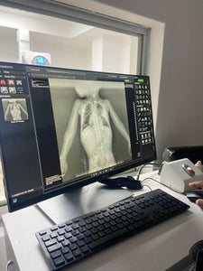

  1. Once that patient is positioned, the imaging procedure is typically quick, easy, and painless. The technician will then review the images to ensure the quality is good enough for the radiologist to diagnose. The radiologic technologist should follow the ABCDE method.
  2. Airways - Look into the trachea and bronchi for anything blocking the patient from breathing properly.
  3. Breathing - The lungs will be examined for any possible signs of disease.
  4. Cardiac - Both the size and borders of the heart should be evaluated, along with the outline of the chest cavity.
  5. Diaphragm - The shape and angles of the diaphragm should be inspected
  6. Everything else- The radiologic technologist should also review the bones and tissues and should look for any implanted devices throughout the body
  7. After reviewing the images, ensure the quality is clear enough to be sent to the doctor.
