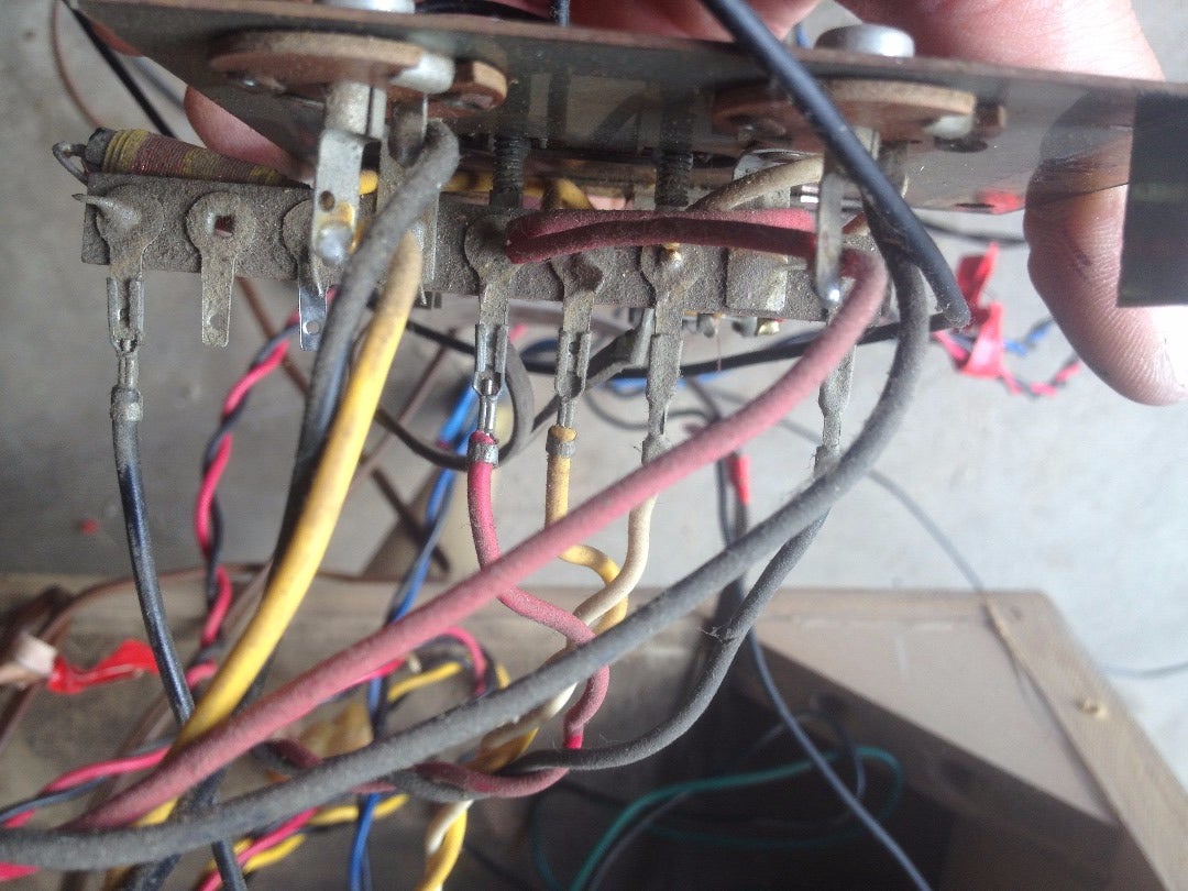

Step 1: Take Pictures and Dissasemble
I began by taking out all the electronic components and disassembled all wood components and hardware.
I taped, labeled, bagged and used containers to group pieces, and laid out all components on the floor.
I took around 50 pictures, and when it was time to re-assemble, I wish I had taken more. I also took notes detailing the order that pieces came off.
It was necessary to have a variety of screwdrivers for this step, and found the Offset Screwdrivers to be especially useful in several tight spots.

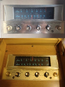

Step 3: Clean Electronics
Fortunately, the speakers, amplifiers, record player, and FM/AM radio all worked when I began this project. The only thing I needed to do was remove the TV and its electronics, and gently clean the remaining components.
I primarily used isopropyl alcohol, q-tips, paint brushes and rags to clean the components. I also used compressed air. I would recommend against canned air, as the air comes out quite cold, and could damage sensitive components.
Phil's Old Radios has good information about restoring and cleaning, and
Expert Village also has informative videos.
For non-electronic components, I used diluted window cleaner.
While removing all components for the TV, I chose to leave all the mechanical pieces for the dials and controls. I wanted the knobs to still operate in the front, and when looking inside the cabinet I like the way they look.

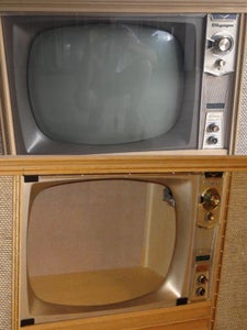

Step 4: Assemble Cabinet and Drawer
To maximize storage capacity, I converted the TV compartment into a cabinet, and installed a drawer beneath it.
Cabinet Shelf
I replaced the bottom of the shelf with a piece of 1/2 in Baltic Birch Plywood. This looks much better than the original piece which had vents and bolt holes for the TV.

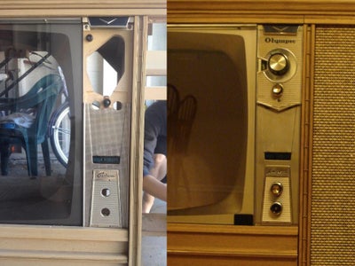

Cabinet Door
I intended to use the original glass, but I dropped it during a test fit... I used a piece of Optix Acrylic instead. It is easy to cut and drill, and less likely to break if I drop it again. I included the plastic TV 'frame' with the door to keep the illusion of a TV screen.

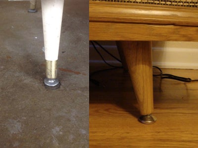

Legs
While modifying the console, I also changed the legs. I cut each leg down 1.5 inches so that the top of the console would sit below a window sill. I also replaced the levelers for a cleaner look.
Hardware:
Swivel Levelers
