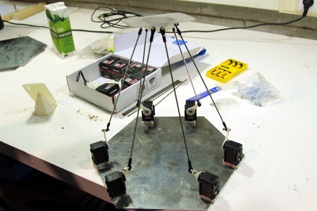

Step 1: Hardware: Modeling, Cutting, Printing and Assembling
We designed the platform using servo motors because they are easier to find and cheaper than linear actuators. The range of motion is a bit more limited, but we were designing for expressiveness and not so much for range.
Before cutting metal and programming motors, Radamés designed a version of our platform using Fusion 360 in order to get some intuition about the range of movements and motor positioning.
The materials we used were:
- 1x RaspberryPi (with 5V/2A power supply)
- 6x Dynamixel AX-12A motors
- 1x UART circuit (with 12V/6A power supply)
- 1x aluminum base
- 1x plastic platform
- 12x M3 ball joints
- 6x threaded rods
- 6x servo brackets
- 6x servo horns
- lots of tiny screws
The servo brackets and horns came with the motors we bought, but we also modeled them in case we needed replacement parts. Simpler acrylic pieces can be used to hold whatever object you need on top of the platform, but since we wanted to hold cellphones in an upright position, we ended up designing a custom platform. STLs are attached here. The servo horns can also be cut from 1/8” acrylic or wood using a laser cutter.
