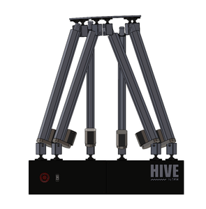

Ever dreamed of creating a versatile robot that can effortlessly move in any direction? Look no further than the Stewart Platform – a dynamic system capable of motion in all six degrees of freedom, driven by the precise coordination of linear actuators. These platforms are commonly utilized in motion simulators and the precise positioning of instruments, such as telescopes.
The exciting part? Building your own Stewart Platform is not only feasible but also surprisingly affordable. I'll walk you through the process of crafting one using stepper motor linear actuators, a Raspberry Pi, wooden panels, and other readily available craft materials. What's more, the beauty of this project lies in its adaptability – feel free to substitute components based on what you have at hand.

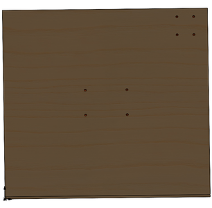

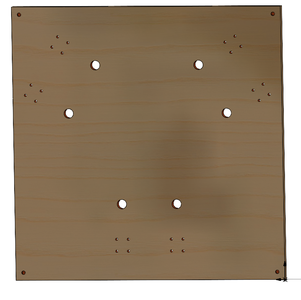

  • 2 Wooden Panels (600x600x10 mm)
  • 1 Wooden Panel (560x510x5 mm)

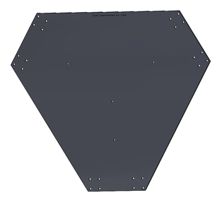

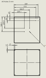

Step 1: Prepare the Bases and the Platform
Note: You have the flexibility to scale the parts according to your specific application needs. The attached CAD files provide the necessary details. For optimal precision, especially in crafting the platform, consider utilizing CNC milling.
  1. Cut the wooden panels to the specified lengths.
  2. Drill mounting holes for the flange bearings in both the upper base and platform. The precise positioning of flange bearings isn't critical; the platform can be arranged at an angle between 60° and 120° to the base.
  3. Cut the aluminum profiles (or alternatively, wooden posts) to 100 mm.
  4. Screw the posts into the four corners of the lower platform.
  5. Divide the cable duct into three pieces and screw them onto the upper base.

Step 3: Mount Linear Actuators
  1. Secure the flange bearings onto the upper base.
  2. Print out the clevises and attach them to the flange bearings (STL files attached).
  3. Repeat the same process for the platform.
  4. Proceed to screw the linear drive units onto the upper and lower fork heads. The Stewart platform achieves stability only when all six drive units are securely fastened. For optimal results, it's recommended to perform this step with two people—one to hold the linear drive units.
  5. Route the linear drive unit cables through the holes in the top base and guide them through the cable channels to the interface board.
