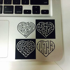

Take a vector or bitmap image and turn it into a vinyl sticker using the GraphTec Vinyl cutter. In this case we're using some heart maze stock image I stole from the internet. Get your own image (black and white works best) and get excited about your sticker.

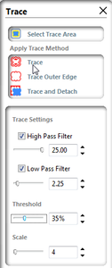

Object > Trace
Click “Select Trace Area” Box-select graphic. Adjust settings. Click “Trace” button.

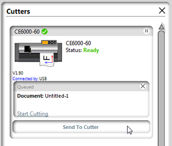

Click Cutter>Send Cut Job>CE6000. “Cutters” menu will open on the right side of the screen. Click “Send to Cutter.”

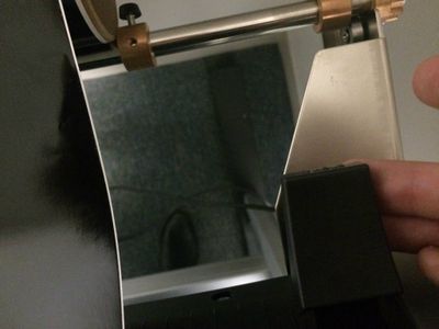

To load material, set roll on rear carriage and feed into cutter, then pull lever on back-right of cutter towards you to secure.

Enjoy your great sticker!
