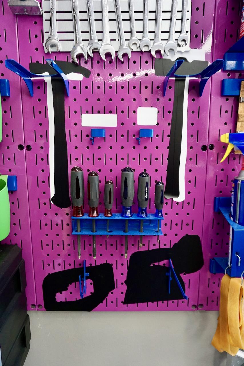

We have Wall Control metal pegboard in both of our garages. Steph wanted a bit more organization on her Wall Control setup and decided to use vinyl to make tool cutouts to create a "shadow board." The idea is to add the cutouts to the wall so you can easily return a tool to its proper place.
Most instructions call for tracing around a tool on a piece of vinyl and then cutting it out with scissors, but you know, no one has time for that nonsense!
She designed a way to make the process a little more seamless using a Cricut Maker to cut the vinyl and her iPhone to create the "shadows" templates.

Before adding shadows to the Wall Control panels, make sure you've organized your tools where you want them. It's not hard to move the vinyl, but it does take a bit of work.
Time to add the shadow stickers to the wall. For most of the stickers, Steph needed to move the Wall Control hooks. Once the sticker was in place, she simply added back the hooks along with the tools.
With the stickers in place, it's easy to find where a tool needs to be stored.
Two different colors of vinyl mean more than one tool goes in this space like these hammers and mallets.

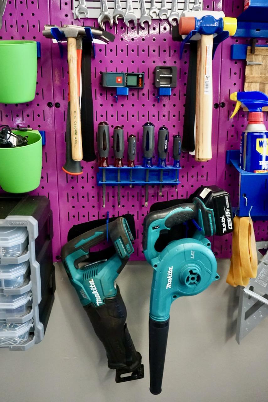

Step 4: A Place for Everything!
You can now tell at a glance where things are to be returned or when something is missing.
This setup is especially useful if you share a garage with someone who doesn't put back things properly!
