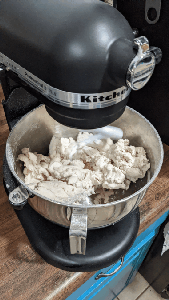

Add all the ingredients below to your mixer's bowl except for the butter and, using a dough hook, mix the ingredients until there's no more dry ingredients. Add the melted butter slowly while it continues to mix. Mix for 10 more minutes.
Roll your dough into a ball, coat the bowl with some oil, add the ball of dough back to the bowl, and cover.
We gave it about an hour to rise, though I'm not convinced that was necessary because we spent the next step kneading it to death, but it's what we did.
