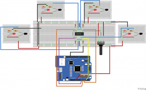

Build the circuit as shown in the diagram and table above.
