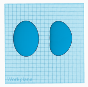

  • Create the basic shape of the stones in Tinkercad

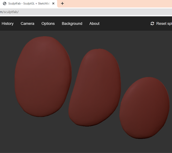

  • Download one stone(shape) at a time and upload it to https://labs.sketchfab.com/sculptfab/
  • Using Flatten tool (default settings), give an uneven shape to the stone
  • Using Smooth tool (default settings), make it smoother
  • Do not use symmetry settings, give better control and a natural look
  • When happy, export the file as STL
