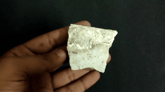

Take the stone you can find it on any street or on beach, But here i did a mistake. I got a marbal stone which looks amazing, it is a white marble, i did everything to look good but at the end, i found that the stone is very heavy, the vibration motor, which i have used is not able to vibrate the stone.
So make sure the stone which you have chosen is super light weight if you don't find the light weight stone then make it with cardboard or with hot glue .
The stones comes in several shapes and size we need a perfect smooth stone which looks like bug, you can easily find that type of stone at beaches But if you dont find a smooth stone, which has perfect size then follow the steps to get it in shape.

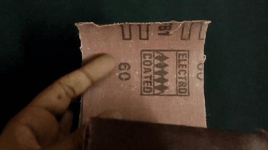

Get a stone and break it as you need with hammer, and after this take a 60 number sand paper and sand it, but here i found sanding stone with sand paper is quite long process, after 2-3 hour of sanding i decided to do it with machine.

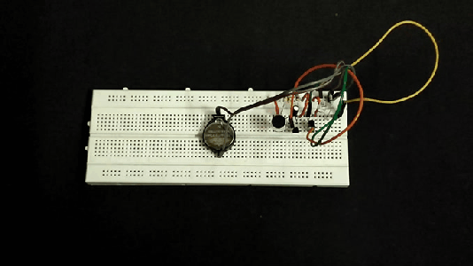

Now firstly make this circuit on bread board to test it properly, i have removed vibrator motor with 220ohm resistor and a LED, while testing becouse the output should be visible. If you want to connect the led, then connect negative terminal of led with collector of 2nd transistor and positive terminal of led with 220ohm resistor, that resistor is connected with positive terminal of supply.
Now clap or talk something the led will glow up , it means everything is going great.

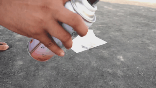

Cover everything along with mic and cell holder with a masking tape, when you are sure everything is protected then it's time to paint. I am using a black spray paint to paint the bug. After the paint job let it to dry, if you want any other colours for your bug your can do it as you want.
