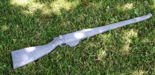

The rifle did not survive the winter weather well. The first year it broke free from the base. I repaired it and last year it broke free again. This time the bolt had broken off - I suspect it was due to being stepped on as a child tried to pet the carving.
When I carved the rifle I wanted a true three dimensional shape. The underside of it was curved and not flat, so ice got under and lifted the piece, breaking the bond with the epoxy glue.
At least, that's my theory.

I made a stone base for the rifle that will raise it up. The supporting stone will have a flat bottom and the rifle sits in a groove carved to fit it. A little bit of sealer was added to the edge to make sure water didn't get in under the rifle.
