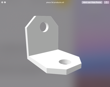

Step 3: Model 3D Parts in Autocad 3d
Then I modeled the squares in Autocar 3d, trying to follow the aesthetics of the original. We placed it in the most optimal way when printing it.
Step 4: Pass File to CNC
After modeling the squares in Autocad 3d, I exported it to the router. I used 18mm wood. And we made 19mm outside cuts to make sure it would cut, with square top cutting bits with 2 1/4 flutes
Step 5: Pass File to 3D Prusa Slider
After modeling the squares in Autocad 3d, I exported it in stl. I used beige PLA. We passed it to the Prusa Slicer program to set all the params
