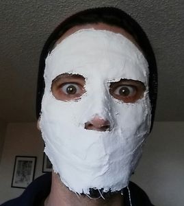

Using the plaster gauze, I made a cast of my face. If you've never done this before, it's pretty much the easiest thing in the world (especially if you have an assistant, but I usually do it on my own). It can be messy though, so wear your crafting clothes and put down a drop cloth, if you've got one. Cut up your plaster gauze into strips, grab a bowl of water and a mirror, and go to town!
You'll want to smear your face with petroleum jelly, or coconut oil, or some other lubricant that will aid removal of the plaster. Then moisten a strip of plaster gauze and lay it directly on your face. Avoid your eyes and leave yourself a space to breathe through your nose, but otherwise, just keep doing that until your face is covered. Be mindful that the edges of the cast need to be just as thick as the middle! They've got to be strong and hold their shape when you lift it off.
You have to wait for it to dry, but it needn't be perfect. You can even hasten the process with a blow dryer, if you're careful. The cast just needs to be sturdy enough to remove from your face, and then set it aside to cure completely.
