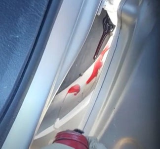

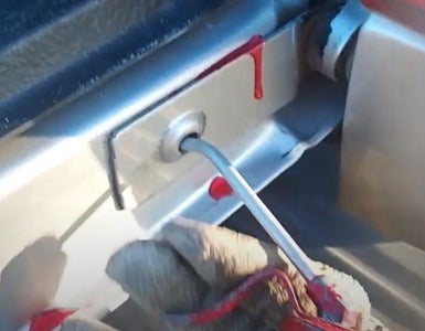

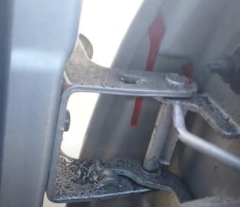

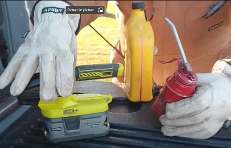

Stopping the rust is a simple process that beats manufacturing a new truck and takes 15 minutes every fall! This short video shows how rust free the 2003 Dodge Ram is! This truck is stored outside year round and sees salty roads in winter. Now 20 years old and no rust thru!!!!! See how to do this one yourself in 15 to 30 minutes I got this truck in 2010 so that is when I started this process.

Castrol 06812 Transmax High Mileage Automatic Transmission Fluid - 1 Quart
https://amzn.to/3gUOckf
SHININGEYES Hand Pump Oil Can Tool, Pistol Oiler Can with Spout Flexible
https://amzn.to/3F2Wz56
XinTan Tiger Pump Oiler Can Professional Level 8OZ Capacity(250ML) Pump Oiler with Handle and 6" Metal Spout
https://amzn.to/3B4d1Ba
Step 1: Spray Time
The video covers the process on what to do every car and truck is different here is the concept.
Step 2: Places to Cover
Here are places to cover (See video)
