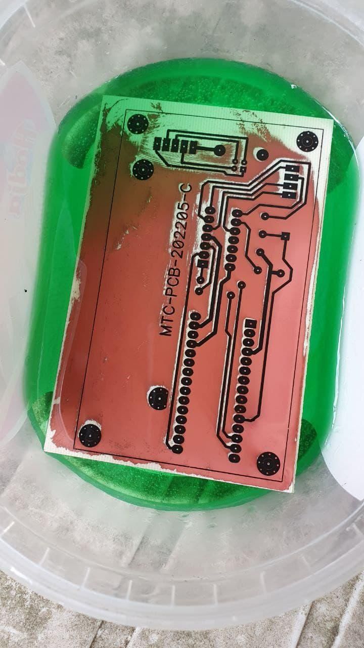

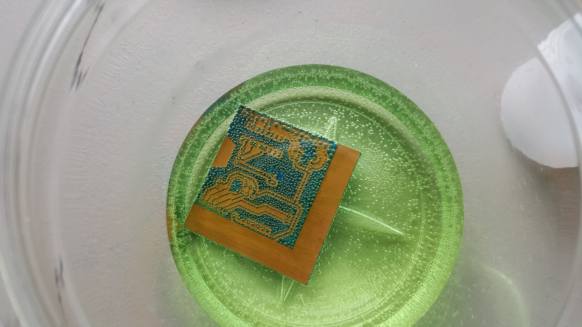

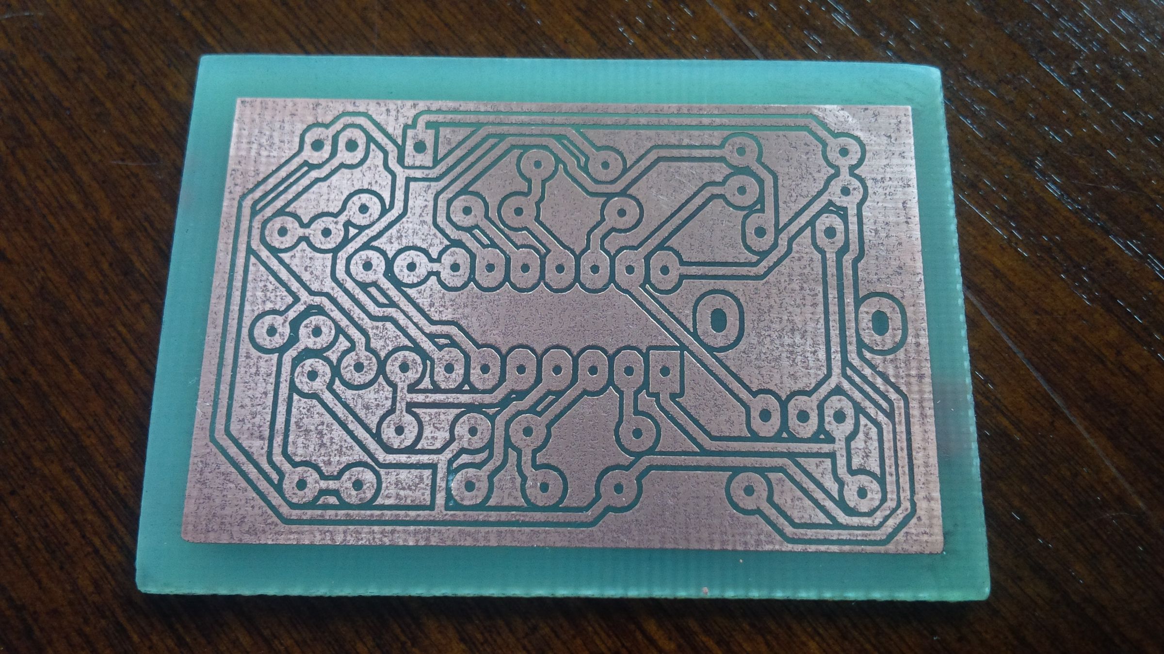

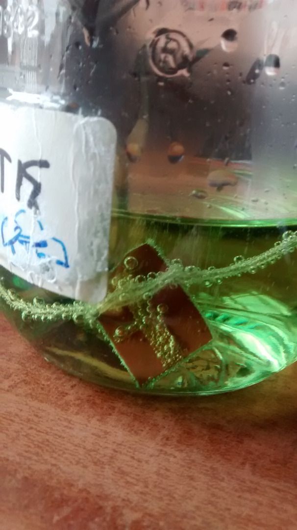

Step 3: Add PCB and You're Etching.
Toss the PCB into the solution and it'll take off.
If this is the first time you're using this batch of solution (and I presume it is), it'll etch super-fast. This small board took only 2 minutes. Yikes!
Since I use a deep container, I tend to swirl it around as it etches. This stuff is so active, though, that I'm not sure it's necessary.
Keep the window open for ventilation because the starter solution gives off a little chlorine gas. (The end-etchant gives off much, much less.)

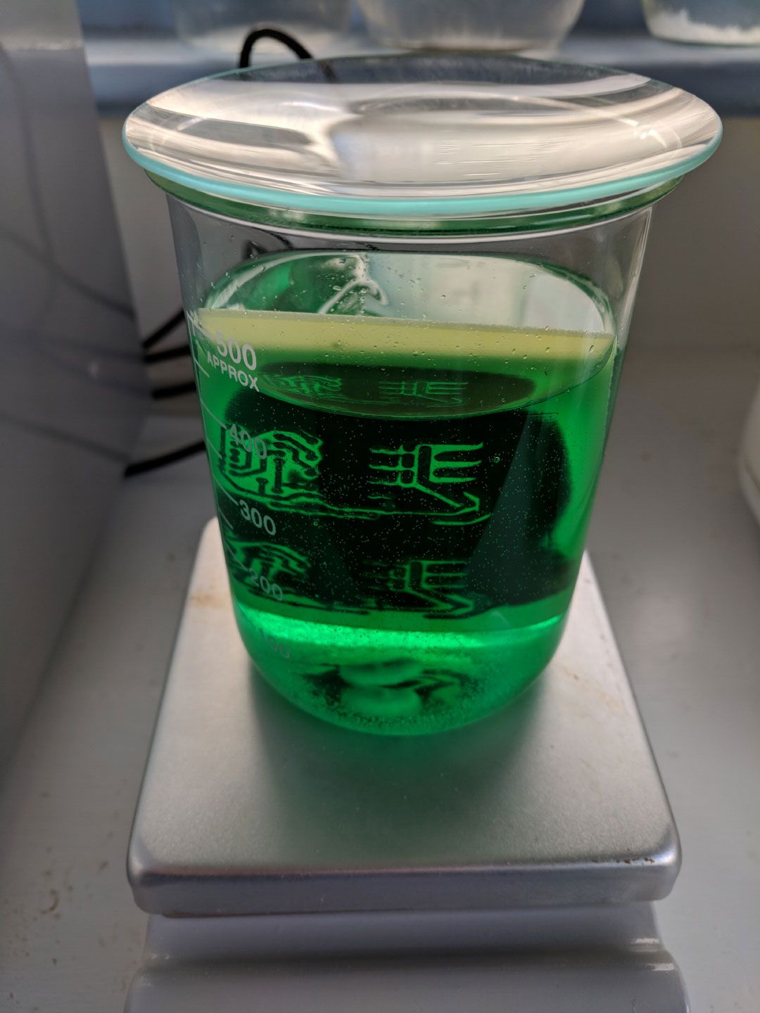

Also, note how the etchant gets greener over time as it eats away the copper. This is good news.
What's happening is that you're dissolving the copper from the board and turning it into cupric chloride. In the long-run, the cupric chloride will be doing most of the etching (instead of requiring disposal). For now, just watch your solution turn light green. Next time you use it, the color will deepen.

Two things to maintain: CuCl2 levels and acid levels.
CuCl2: After all the peroxide is used up, and the solution starts turning brownish, you'll have to add oxygen to regenerate the solution again: toss in a few more capfuls of peroxide or bubble air through the solution or swirl it around vigorously, or just pour it into an open container and wait. It's easy to tell when you're ready to etch again, because the solution turns green.
It's also impossible to add too much oxygen by adding air, so bubble/swirl to your heart's content. If you're using peroxide to add oxygen, be sparing -- a little goes a long way, and it's mostly water so you're diluting your etchant by adding it.
Acid: Note that HCl is being consumed in the starter etchant and the regeneration reactions. So we're going to have to add a bit more acid as time goes by. If you notice that it's harder to re-green your brown etchant, it's probably time to start thinking acid.

Great instructable! I have etched numerous boards using this, but I'm running into a big problem.
After leaving the solution set idle for about a week, it etches at a very, VERY slow pace, despite putting in chunks of copper boards in and stirring like mad just to agitate the solution after leaving it set. I have noticed that the bubbles in the initial mixture have disappeared too and it now looks like flat soda, if you understand what I mean.
I have it stored in a plastic container that I think is airtight.
My question is how do I regenerate it, or do you even regenerate its potency? The solution works well, but only if you constantly use it, I suppose.
Reply 2 months ago
I think I solved the problem - you were right The Real Elliot, it was a lack of oxygen! To solve it you either need to stir it like crazy so it regenerates oxygen or introduce oxygen to the system. I wonder if an aquarium pump would help with this???
Reply 5 months ago
Might be that it doesn't have enough oxygen? Toss in a capful of peroxide and see if that helps? Besides slowing down, an indication of needing more oxygen is that it gets dark or even brownish. A pretty emerald color is what you're aiming for.
If that doesn't do it for you, and especially if you've dissolved a bunch of copper already, it could be that the solution isn't acidic enough. In that case, a capful or two of additional acid should do it. You can calibrate it with lye, as mentioned, but in my experience neither excess oxygen nor acid hurt all that much.
