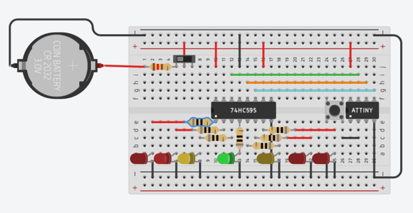

- Battery
- The battery first has 3 volts. We supply this to a 120Ohm resistor so we can reduce the voltage for the project. Otherwise the 3 volts has to much voltage for the 74HC595 shift register when we start using it.
- After the resistor, we go to a 1 amp switch. This will turn the project on and off.
- ATTiny85
- This will be the brains of the operations. We will have to program the attiny85 using the provided code in the project. It is important to note the orientation of the attiny85. The top of it has an intend which is shown in the pinout diagram. That will help you know what pins to use.
- Attached to this step is the pinout diagram of the attiny85
- We need to connect pin 8 to the power rail supplied by the battery.
- We need to connect pin 4 to the ground of the battery
- Next, we can connect pin 2 to one side of a pushbutton. The next closest rail on the button will be connected to ground. In the code we check to see when we receive a ground signal and that will be how we control the user input in our game
- Pins 5, 6, 7 will be connected to the 74HC595 and I will explain how they work in the next section
- 74HC595
- This is the 8-bit serial in, parallel out shift register with a maximum power consumption of 80-µA. For a more detailed explanation, here is the datasheet. Our goal with this is to send in a signal one bit at a time to control many LEDs with just three outputs. Here is the website I used for some of the details about these pins.
- Pins 1-7 are our output pins, meaning we can connect these to the 80ohm resistors then to an LED. We can tell the shift register what LEDs we want to light based on what pin they are connected to.
- Pin 8 should be connected to ground.
- Pin 16 is power and is connected directly to the power rail.
- Pin 14 is the DS pin(Serial Data). We will tell this pin which of the 8 LEDs to light up. This should be connected to pin 5 of the attiny85. In the code, we will set the bit to which LED we want to light up and it will be sent through this signal.
- Pin 13 is the OE(Output Enable) pin which can be connected to ground. It needs to be held at low for normal operations so we don't use the output data.
- Pin 12 is the STCP(Latch) pin. This pin will connect to pin 6 on the attiny. This will update and control the next LED and tell it to be set or to shut off.
- Pin 11 is the SHCP(Clock) pin. It is essentially the clock from the micro controller.
- Finally, pin 10 is the Master Reset. This needs to be geld at high and connected to the power rail so the operations can perform normally and so we don't need to clear all of the operations.

For the setup function, we have 3 outputs and one input_pullup. The three outputs are the latchpin, datapin, and clockpin. If you recall from the previous step, we will have to connect 5, 6, 7 to the shift register. The buttonPin will be connected to pin 2 on the attiny85. When pressed, it will send the ground signal to pin. In our loop, we are constantly looping to see if the user is pressing the button or not. This is what the digitalRead function does. Now we have 3 different gamestates we will be looping through depending on what stage of the game you are in.
- Gamestate 0:
- This is while we are at the start menu. We wait for a press and once we receive one the next gamestate/animation will start
- Gamestate 1:
- This will run the first simple animation. It will start from both ends of the LED's and light them up towards the middle. Once the middle one is lit up, the next gamestate will start,
- Gamestate 2:
- While the game is playing, it checks to see when the user has pressed the button or not. If they have, it checks what LED the game is currently on. If it is on the middle LED, we win and the game switches to the next mode and speeds up the game. If we lose, the LEDs turn off and the game switches back to mode one.
- Also while we are in game two, it is constantly updating the shift register by opening up the latch pin and allowing us to enter in the bit that needs to be set then closing the latch pin.

For this process, we need to solder the components together. Luckily, this step has been made simple because we know everything will work due to prototyping on tinkercad. We just have to slide the individual pieces on the breadboard and solder them down according to this diagram. For this, I used a PCB board that I was able to put my pieces in place and solder them.
