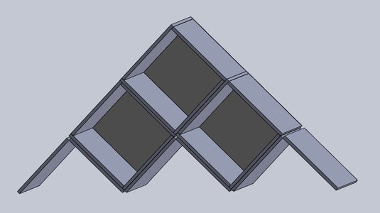

Stacking vertically is functional and works well, but the ability to stack diagonally adds a whole new dimensions of use.

Before starting construction, Solidworks models were created to set dimensions and visualize assembly.
