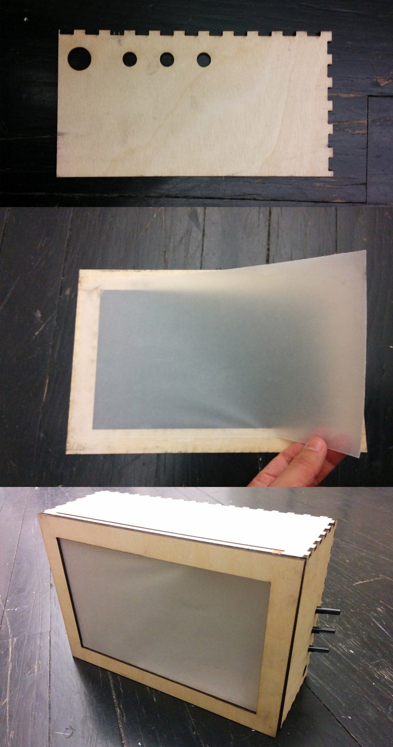

Step 2: Construct the Box
Laser cut each piece for the box and put them together. Be careful to leave a crack on top and a few holes on the side. Make sure story boards can be put in and potentiometers can be reached from outside. Then, make the front board with a frame and tracing paper.

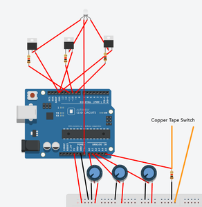

Step 4: Understand the Arduino Circuit
The circuit logic is shown in the picture. Understand it before you build it.

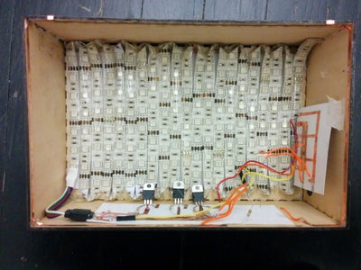

Step 5: Put Things Together
Follow the logic flow and build the circuit in the way that fits your enclosure.

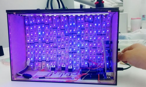

Step 7: Upload the Code
Upload code to Arduino and test it.

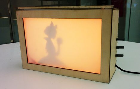

Step 8: Enjoy!
After put a storyboard in, the shadow will be casted on the front. By turning the potentiometer, you will be able to change the color to match the story. And by turning all three to maximum, the light color will be looped. Enjoy a great story time!
