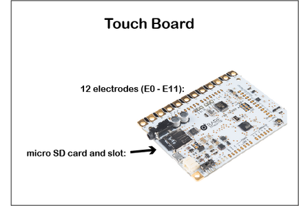

Step 5: Prepare the Touch Board
Each Touch Board comes pre-packaged with a micro SD card in a slot on the device (see photo). This card already has sound files saved on it that can be replaced with new ones. To replaced the files, remove the micro SD card and insert it in a card reader.
Make sure that each sound file is saved as an MP3. If they aren't in MP3 format, you can always use an online MP3 converter.
Each Touch Board follows a naming structure: TRACK000.mp3 is for electrode E0, TRACK001.mp3 for E1, and so on, up to TRACK011.mp3 for E11. You'll see "E0" through "E11" marked on the edge of your Touch Board near the gold-plated electrodes.
Note: You do not need to re-program the Touch Board.
