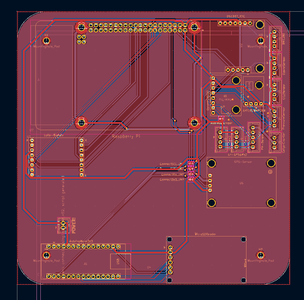

Step 1: Order the PCB
First, download the PCB design files from my GitHub repository. If you want to customize the design to better suit your project, you can edit it using KiCAD, a free and open-source PCB design software.
Once you're happy with the design, you'll need to create what's called Gerber files — these are standard manufacturing files that PCB fabrication companies use to produce your board. KiCAD can easily generate Gerber files through its built-in export tools.
After generating the Gerber files, you can upload them to any PCB manufacturer to have your board made. (I personally chose Aisler because their service is very beginner-friendly — you can simply upload the .kicad_pcb file directly without needing to generate Gerber files manually.)

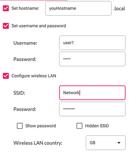

The first step is to create a bootable SD card for the Raspberry Pi. To do this, I recommend using the Raspberry Pi Imager, a simple and free tool available for Windows, macOS, and Linux.
When selecting an operating system:
  1. If you plan to write your code using Visual Studio Code via SSH (which I highly recommend for convenience) or directly through the terminal, you can choose the 64-bit Lite version of Raspberry Pi OS.
  2. If you prefer using a graphical interface, it’s better to choose the standard 64-bit version of Raspberry Pi OS.
Once you've selected the OS:
  1. Choose your SD card as the storage device and click Next.
  2. A window will pop up, allowing you to customize the OS settings.
  3. If you want to use VSCode or SSH, you should configure these settings now:
  4. Set a hostname to easily find your Pi on the network.
  5. Set a username and password for later login.
  6. Configure your Wi-Fi network settings if you're using a wireless connection.
  7. In the Services tab, make sure to enable SSH.
  8. If you’re unsure about the options, select Password Authentication for a simple and secure setup.
After customizing these settings, finish the flashing process and your SD card will be ready to boot your Raspberry Pi!
