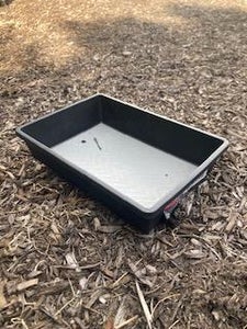

  1. 1Qty plastic brick forming tub

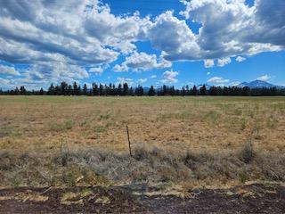

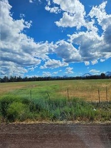

The requirements that this type of structure would need in a certain site is a property with a dirt and/or clay source on it and an accessible construction site. The layout and plans that I have made for a cob house are made for a two person living space or a small family; but can be changed for smaller or larger purposes. A perfect site for the cob house is an off grid dry grassland area where it can be used as a cabin or home. The cob house could also have solar panels hooked up on the roof to provide a sustainable electricity source if needed. Out in the dry climate of a grassland this cob house would provide a cool escape away from the heat of the grassland and hold its heat during cold nights because of the straw insulation used within the walls. The grasslands could also provide almost all of the main building materials needed, like the long grass for the insulating and the dirt/clay used in/on the walls. The cob house would also blend in with in the grassland environment and make a smaller impact on the surrounding plants and animals because of its natural look and feel.
-The captain of this project was me and I had one other person to work on this with me on my team.

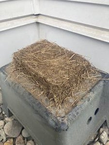

Cob House "Brick" ⬇️

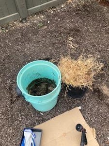

Step 1
-Mix water and dirt until you have a watery soupy dirt/water mix.
Step 2
-Next generously pour your dirt water mixture onto a small pile of straw and mix.
Step 3

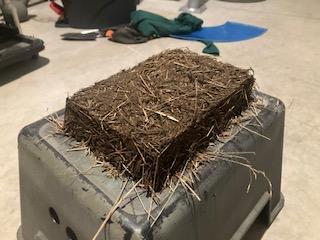

-Compact this straw and dirt mix into a small plastic tub(the tub should be able to form a brick like form) until the mixture reaches the top.
Step 4
-Let dry until completely hardened and then remove the straw and dirt mix brick from the mold to finish.
Note:
-To connect bricks apply a moist thick dirt/clay water mix between each brick.
