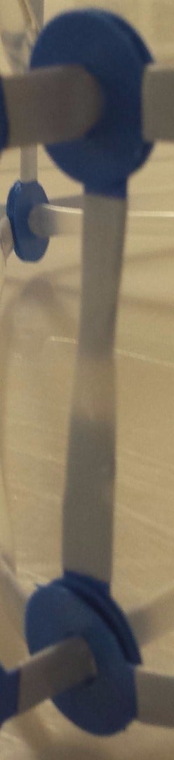

Step 2: A Couple of Key Tricks
The two things you want to pay attention when building is the orientation of the connectors and that they are fully inserted into the straw. You want the straw to go all the way up to the hub on the connector.
For this build, you also want to ensure your hubs are either parallel or perpendicular to each other at both ends of the straw. If they are off by a little bit, you don't get a very sturdy build and you'll be forever adjusting things trying to get it working.
To ensure the straws are cut accurately, make the first one for each size your ruler for all the others. Don't switch pieces from one cut to the next or you'll find that small errors will accumulate. The 25% and 50% cuts are good approximations and if you're off a bit either way, the ferris wheel will be fine. The key is making sure all of the 25% pieces are the same and that all of the 50% pieces are identical.

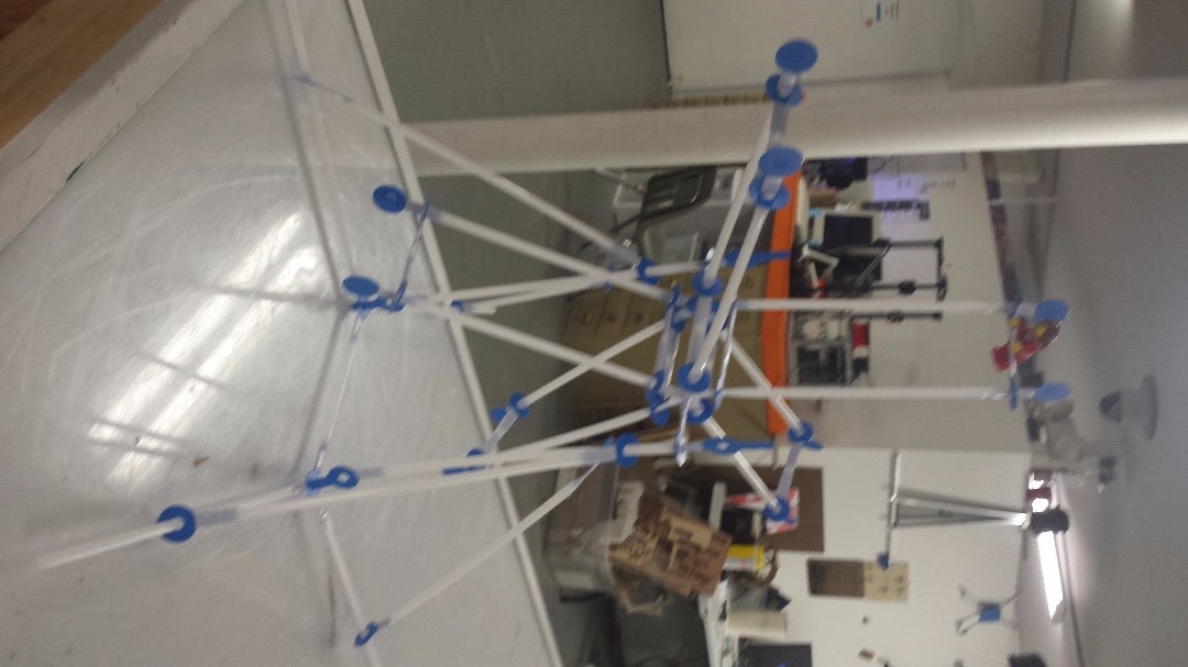

Step 3: The Base
The base uses the full size straws, 1 50% straw, 10 single hubs, and two triple hubs. Build as pictured.
Note that the diagonal supports are using friction to maintain their positions. You'll be able to move them on both tends to square up the frame once the ferris wheel is mounted.

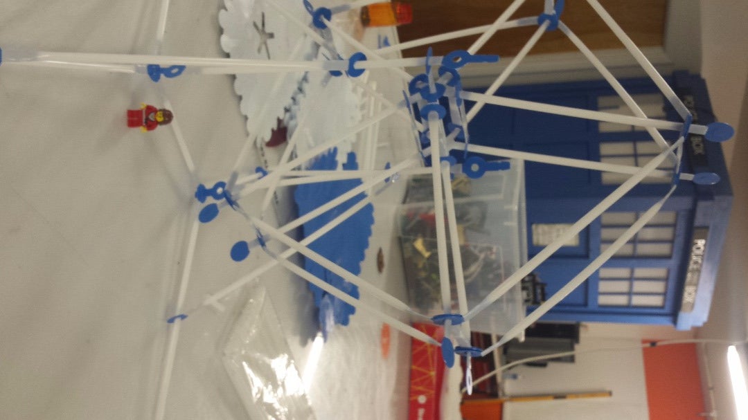

Step 4: The Wheel
The wheel itself is pretty easy too.
  1. Take all ten 25% straws and insert single ends into both ends. These should be parallel to each other.
  2. Put five 75% straws onto the spokes of each the quintuple hubs.
  3. Slide one of the 25% straw assemblies onto each 75% straw so that one hole is on each spoke. You'll press these down onto the quintuple connector spoke to lock them in place.
  4. Slide the remaining 25% straw assemblies onto each 75% straw just as you did with the first group. They're going to be locked in shortly
  5. Add a double spoke connector to each hub. As you add them, plug the end holes for the 75% straws with a single spoke connector.
  6. Lock the double spoke connector onto the outside ends of all ten ends.
  7. Lock the 25% straw assemblies to the outside ends next to the double spoke connectors.
  8. Add the remaining 75% straws to complete the perimeter of the wheel.
This is the time to make any minor adjustments to the connections to ensure the wheel is as regular as possible.
