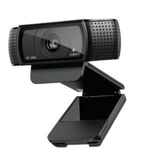

  3. USB Camera or Pi Camera Module
  4. USB Microphone or USB audio adapter with microphone

Camera Connection - USB Camera
  1. Plug USB camera into any USB port
  2. Verify with: ls /dev/video* (should show /dev/video0)

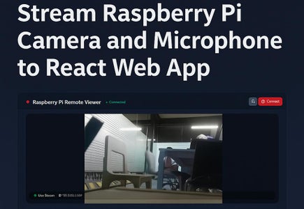

Step 6: Final Result – Stream in Action
After completing the setup, here's what your Raspberry Pi Remote Viewer will look like in action.
✅ When the connection is active, you will see a live video stream from your Raspberry Pi's camera along with the IP address displayed on screen.
❌ When disconnected, the interface shows a friendly message prompting you to start the stream.
This clear separation between connected and disconnected states enhances user feedback and improves the experience on both desktop and mobile.
🧪 Make sure your Raspberry Pi is on the same network and running the WebRTC streaming server script.
