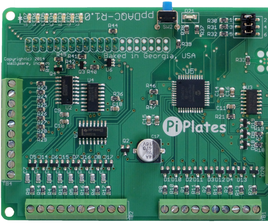

The Pi-PlatesppDAQC Data Acquisition and Control board is an ideal interface between sensors and a Raspberry Pi. With eight analog and eight digital inputs, up to sixteen channels of real world data can be captured by a single ppDAQC Pi-Plate. But, what can you do with that data? You can use it to control a process by turning around and driving the Digital and Analog outputs on the board. But chances are you will also want the ability to monitor it. Furthermore, the beauty of small, inexpensive single board computers (SBC) like the Raspberry Pi, is that they can be used in remote locations without a keyboard or a monitor. All they need is a source of power, and a WiFi adapter. Using a SBC in this way is referred to as a “headless” setup.

- A Raspberry Pi which has been preloaded with the ppDAQC Python module. Go here if you need to perform this step.
- A ppDAQC board from Pi-Plates.com

Using the materials called out in the previous step, perform the connections as shown in the drawing. Note: we were out of luck when we went looking for the 4.7K resistors so we ended up putting two 10K resistors in parallel.
