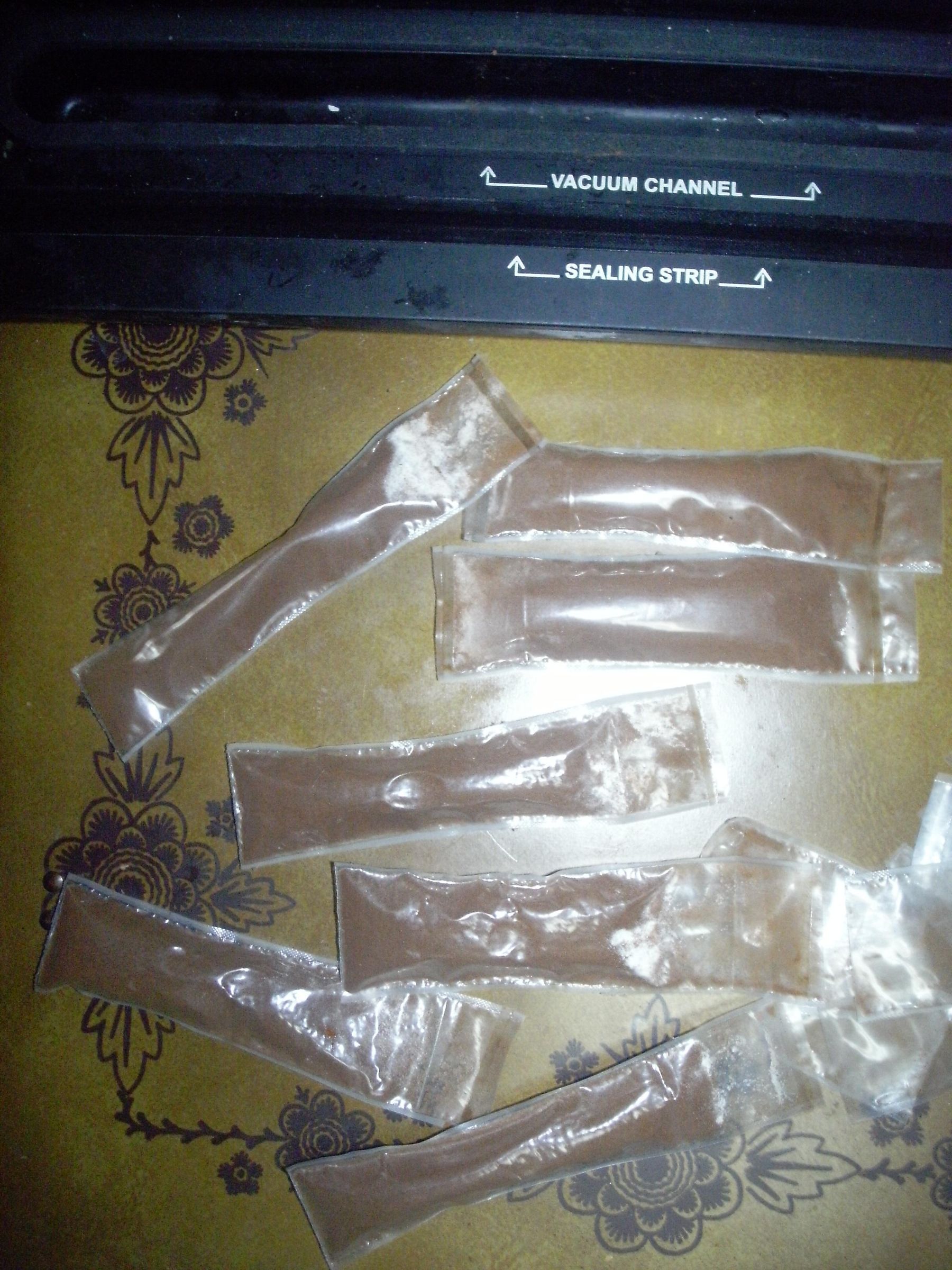

Most people would wrap their connections with electritians tape but I like to use the silicone rubber because it is less bulky.
Mix little bits of the 2 part silicone mold compound together and roll it out into short lengths. Press it flat and wrap theach solder joint with them making new insulation.
It is important that you do this a little at a time because the amount is so small the curing time is really short. So just mix enough for one wire at a time.
Then twist the cables to wind the wires and wrap it with the uncured rubber tape. Again you can use Electritian's tape, but this way it never unwraps.
