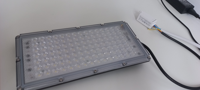

Step 2: LED Streetlight Connections
- 1 – Live (L) - brown
- 2 – Neutral (N) - blue
- 3 – Earth (E) - green/yellow mixed

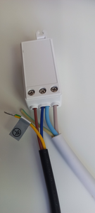

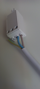

Step 3: Connect the Mains Plug to the LC01
Strip about 1 inch of the outer insulation from the cable. Then, strip the insulation from the blue and brown wires. The green wire is not used.
Using a Phillips head screwdriver (make sure it matches the size of the screws), loosen the two IN L and N screws by turning the screwdriver counterclockwise. Do not over-loosen the screws, as this may cause them to fall out of the terminal. As you loosen the screws, you will notice a widening gap between the plastic housing and the metal terminal.
- Connect the other end of the LIVE wire (usually brown) to the terminal IN (L). Then, using the screwdriver, tighten the screw clockwise.
- Connect the neutral wire (usually blue) to the terminal IN (N). Don’t tighten the screw yet because this terminal share the both input and output.
Step 4: Connect the LED Streetlight to the LC01 Output Terminal
- Connect its live wire (usually brown) to terminal OUT (L). Then tighten the screw clockwise using the screwdriver.
- Connect its neutral wire (usually blue) to terminal 4 (Output Neutral). Now tight the screw to secure both neutral wires.
If your device has an earth/ground wire, connect it to the earth/ground wire of the plug cable. Use a connector rated for AC power to join the wire ends.
After connecting both the power code and the street light (or any other appliance), your wiring connections should look something like this (see the left image).

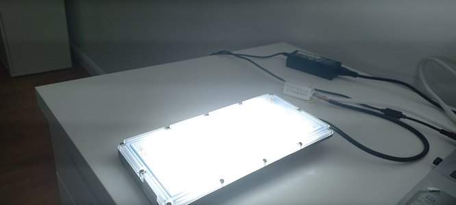

Step 13: Testing the LC01 Relay With a Downlink Command
Now we are going to control the LED Street light from The Things Stack.
- Click the Messaging tab.
- Make sure the Schedule downlink tab is selected.
- We use FPort 1 for sending downlinks.
- Ensure Bytes is selected as the Payload type.
- To turn on the LED street light, enter the payload 06 01 (in HEX) in the payload field.
Then, click the Schedule downlink button.
- You should see the LED street light turn on within a few seconds. (Some delay is expected with LoRaWAN downlinks.)
If you are in an area with poor LoRaWAN network coverage, the network might not be able to deliver the downlink to your device.
- To turn off the LED street light, enter the payload 06 00 (in HEX) in the payload field.
- Then, click the Schedule downlink button.
