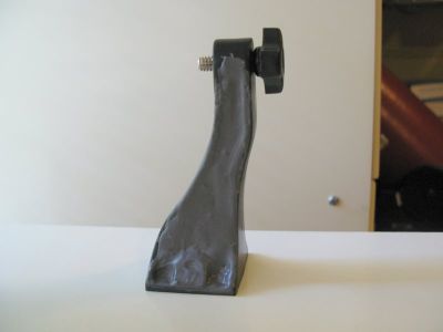

The first photo shows the strengthened adapter. The second shows the "before".

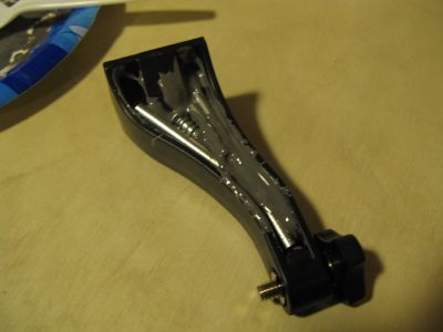

First, find scrap metal that can fit into the hollows of the plastic object.
Then, mix up the epoxy for one side of the object (if the object has more than one side). Try to keep the proportions as per directions--1:1 in the case of JB Weld--and make sure that everything is thoroughly mixed. In the case of an epoxy where the two parts are different colors, like JB Weld, this is very easy to tell. Keep things well ventilated. I like to mix up epoxy on a paper plate.

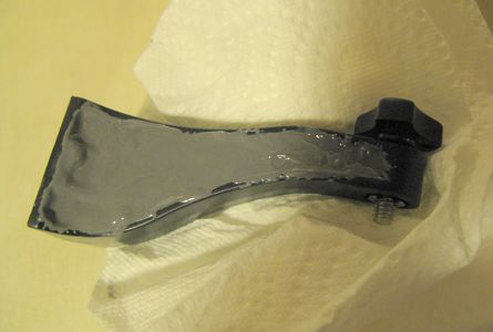

Cover up anything you don't want to get epoxy on with painter's tape. First, put down a bit of epoxy. Then insert your scrap metal. Then fill in the hollow areas with the epoxy. (I also did some hollows on the underside.)
Pop any bubbles and smooth a little. If the epoxy is slow curing, you don't need to smooth it very much--gravity will do it for you. Wipe off any excess epoxy.

Now leave the epoxy to cure, but make sure that the object lies in such an angle (I used the crumpled up paper towel to do that) so that the epoxy doesn't pour out of it--keep it horizontal. The epoxy may be thick, but if it's slow setting, it's going to flow for a couple of hours.
You may want to monitor from time to time to make sure things aren't lopsided.

The photo shows the first side. The second side is curing more slowly--I think I didn't get the proportions quite right. JB Weld turns duller in color once it's cured. The photo shows the side that's done.
The resulting adapter should be much, much more stable. (I haven't tried this one yet, but I have used another one I did earlier.) It also has an impressive "expensive-feeling" heft, since it now weighs in at 4.5 oz.
