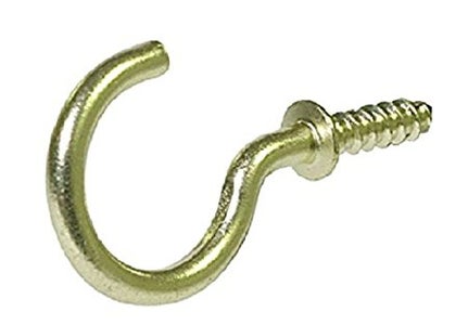

2. 7/8″ Brass Screw In Hooks. You’ll need 3 packs of at least 36 hooks, but I have linked to a pack of 40 since its cheaper than the 36 pack.

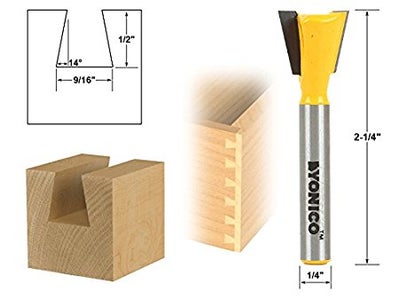

1. A router. The cove in the wood was made with a dovetail router bit 1″ from the top of the board and the LED strip sits down inside this recess to keep it hidden from direct sight.

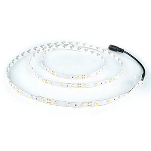

2. LED Strip lights. I used a warm white light which provides a pleasing glow across the strands, but if you want to get fancy you could use RGB strips and control what color the light is.

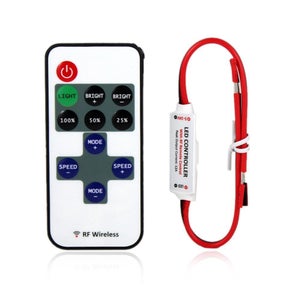

3. An LED light controller. The one I chose is an RF frequency that operates with a wireless remote. I think this is better than IR (infrared) since you don’t have to actually point the remote at the receiver for it to work. In fact, I leave the remote downstairs and the receiver is hidden upstairs in another room. If you RGB lights, you’ll need a different controller that works with RGB.

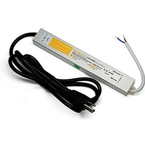

4. 30 W Power Transformer for LED’s. This will allow you to plug the LED’s directly into an AC outlet.
Specs
The LED light strip listed here is a 16.4′ roll, 12V DC strip. Outputs 82 lumens/foot at 1.5 watts per foot. There are other, more powerful light strips available, but this is already a bit too bright and I generally use the dimmer at about 25% for a muted, glowing effect. The dimmer is about as simple as dimmers get, so feel free to get a fancier one. It has controls from 100% all the way down to 10%, and will remember the previous input when turned off and on again. It has 8 dynamic effects, similar to Christmas lights, but they are just about useless here, but it can be fun for kids to play with.

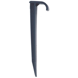

2 drip irrigation spikes

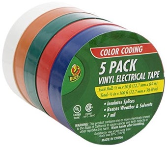

Electrical Tape

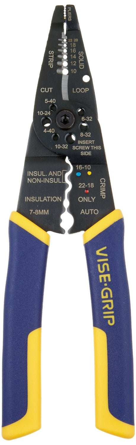

Wire Strippers

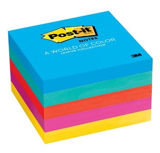

Post It Notes

3. Use your dovetail router bit to cut a groove all the way through the board 1″ from one of the edges. This is where the LED strip will sit. Having it recessed allows the light to come out onto the strings but keeps the actual LED hidden, so it’s not blinding.

5. Drill 36 small pilot holes in the middle of the board running lengthwise down the board, equally spaced 1″ from each other and 1″ from the ends.
6. Screw in 36 7/8″ hooks, all facing the same direction, which will likely have to be adjusted later. Once you get the boards on the wall, you want the opening facing down. (towards you)
7. To install the LEDs, cut strips just shy of 3′ and slide into the dovetail groove on the boards.
8. Solder a wire at the end of each strip and leave enough extra wire to reach the next set of wires on other boards. For now, leave them dangling.
9. Solder the RF remote to the + red input of the power supply and select a location for this. Lucky for me, my installation is sharing a wall with an upstairs bedroom, so I plugged in the power supply to a wall outlet in that room and drilled a small hole through the wall fed a wire through the opening into the foyer where the LED strips could be connected. That way, my power pack is hidden. If you can’t do this, consider running a cord down the corner of the wall and into a place where you can hide your power brick.

11. Now lets make your “sewing needles”. Basically, you’ll need a long pvc pole tipped with the drip irrigation spikes, which is secured with duct tape. Through the end of the drip irrigation spike I drilled a small hole through which I thread the string through. The pvc needs to be long enough to comfortably reach your hooks. I used 8′ poles (since I had them already) and stood on a coffee table to give me a little extra height.

13. Now to begin weaving: I had a Left/Middle/Right designation for my three boards, and if you pull up the excel sheet showing my pattern I created, you’ll see the term L1 for Left – 1st hook. (M4 – Middle 4th hook, etc.) Also, it really helps you keep track of where you are if you put post it notes below the hooks and label them 1-36. Basically, my pattern is as follows
