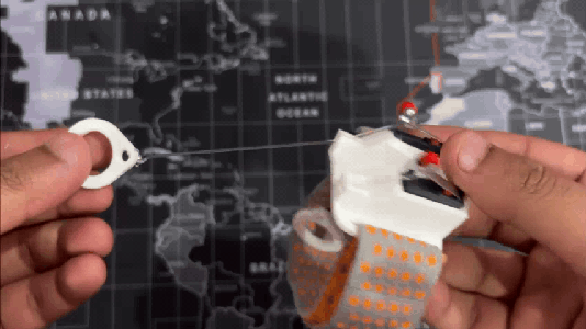

Our design has a wrist-mounted controller, which eliminates the need for holding a typical controller. Instead, it uses carefully placed limit switches that operate with finger movements, providing simple control by just curling or bending the fingers.
Each switch is linked to a lever mechanism, with a string connecting the lever to a ring worn on the finger. When the finger moves, the string pulls the lever, which triggers the switch.

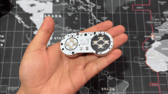

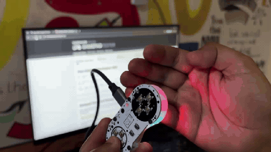

For this project, we are utilizing our previously made POCKET SNES controller as the base for this project. Base here means we are using this Pocket SNES as the main controller, and we will be adding our custom wrist-mounted contraption with this setup. Let's have a recap of the project: the RP2040-Tiny mini development board, which is an SMD or module version of the Raspberry Pi PICO, serves as the controller brain.
The RP2040 Tiny Module was installed on a controller-shaped PCB that had small SMD tactile buttons on one side and the RP2040 controller on the other. To increase the controller's grip, an enclosure is added to the bottom side of the PCB, making it easier to hold.
You can check out the full build guide about this project from the link below.
https://www.instructables.com/Pocket-SNES/

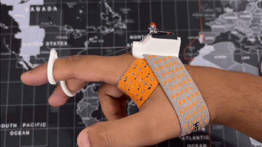

Step 2: STRING CONTROLLER DESIGN

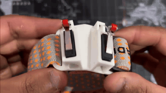

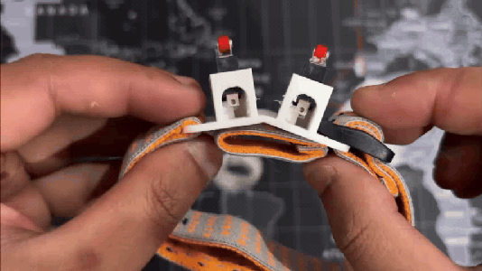

Let's have a look at the design of the Wrist Mount Part, which was really straightforward to put together. We just installed two lever switches near the knuckles of the hands, then modeled a holder to keep these two switches in place.
Each switch faces the finger; the first switch is for the index finger, and the second is for the middle finger. Our goal was to add a string with a lever to these limit switches, followed by a ring-like part that will be put on both fingers. Because the string is attached to the switch's lever, when pulled downward, the switch registers a click, which is how our controller works.
This was merely for testing whether or not this idea works; therefore, we only put up two limit switches, but we could modify this setup to operate five switches utilizing our five fingers.
After finishing the model, we exported the STL files for the Switch Holder and rings and printed them on our Creality K10 max with a 0.4mm nozzle and 0.2mm layer height.

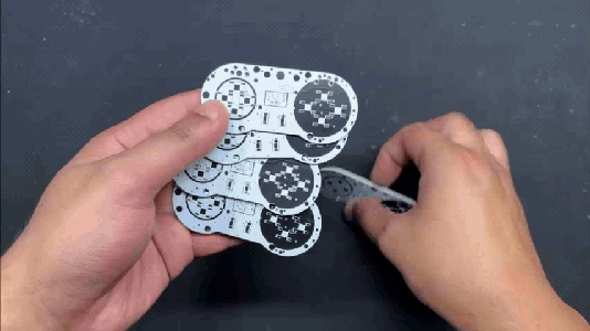

Step 3: PCBWAY SERVICE
For this project, we are reusing the SNES Mini PCBs provided by PCBWAY. The order was placed for a white solder mask with black silkscreen PCB.
PCBs were received within a week, and the PCB quality was outstanding. Here, we added a few design elements on the board's silkscreen layer to increase the aesthetic appeal of the project. PCBWAY made the custom layer properly, which shows their great PCB manufacturing capabilities.

Step 4: BASIC SETUP

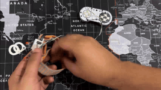

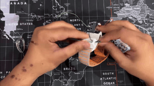

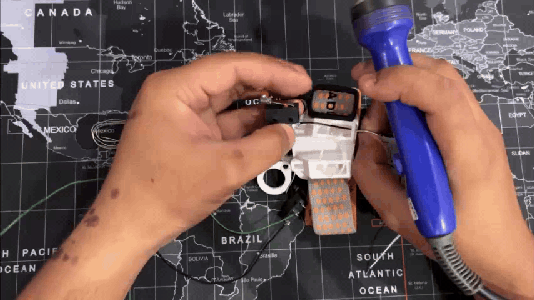

  1. The assembly process for this small experiment was rather simple; limit switches were attached to their designated places on the switch holder part.
  2. We tied a knot on each Limit Switch lever to secure the 1mm string. The other end of the string is linked to the Ring Part.
  3. To wear this device, we attached an elastic belt salvaged from an old adventure wearable LED headlight.

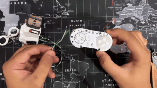

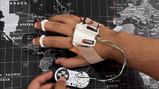

Step 5: PAIRING WITH SNES CONTROLLER

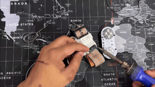

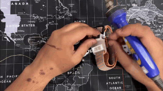

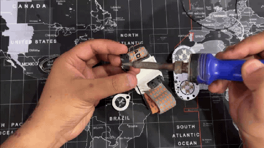

This is the main section of the project, which involves connecting the limit switches to the SNES controller.
  1. We begin by soldering connecting wire to the first Limit switch's COM and NC terminals. We then route the wire through the opening on the back side of the holder and install the limit switch in its place.
  2. We then repeated the process with the second Limit switch, connecting one wire to the COM terminal and then to NC, but this time we added a single short black wire to the COM terminal, which will be connected to the first Limit switch's COM terminal. This will link both limit switch COM terminals in parallel, allowing us to connect this wire to the GND of the SNES controller.
  3. The three wires from the limit switches (COM, First Limit Switch NC, and Second Limit Switch NC) are connected to the SNES controller buttons. We connected a COM wire to the GND terminal of the SNES Controller. The first limit switch NC wire is attached to the left button, while the second switch NC wire is connected to the right button.
After attaching the wires, our setup is complete; now we'll add the new code to the SNES Controller and test it.

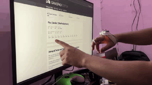

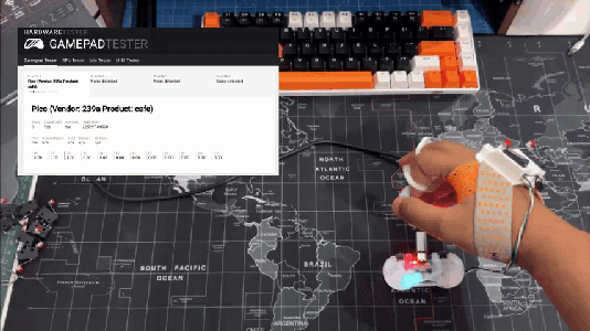

After uploading the code into our SNES Controller setup, we utilize a website called game pad tester to test that our button input functions correctly. Using this site, we were able to confirm that our device was functioning.

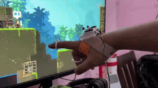

Step 7: RESULT

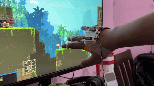

The end result of this experimental project is a wearable game controller that operates exactly like a standard one. What's the key difference? Instead of pressing buttons, movement is controlled using finger movements.
This was achieved through a simple string-based approach in which a limit switch is linked to a string. When the string is pulled downward, the switch triggers, pulling a GPIO pin to GND, which is detected by the Raspberry Pi Pico. This clever contraption allows intuitive movement control with only finger motions!
To put this to the test, we opened Broforce and mapped our controller in the Controller Mapping option. We set the first limit switch to move backwards and the second to move forwards.
We could control our character's movement with both fingertips, effortlessly moving it forward and backward. We couldn't use all of the features because the setup only had two buttons, but for an experimental project, this demonstration was ideal.
This Project was a success!
