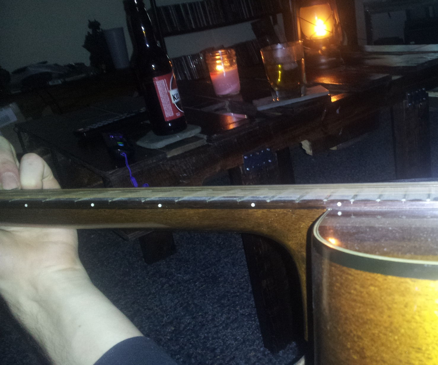

Tools, highly recomened for this step; Dremel (standard usefull bits sandpaper wheel, drill bits, various grades of sandpaper, and sharpening stone for sharpening that old dull chisel you had laying around), knife, knife sharpener, chisel, and a wood rasp (preferably like the one I got with a flat side, a curved side, and a side file). Take your chisel and lower the profile of where the headstock is going to be, its got to be lower than where the is going to be or else your string is just going to hang there (note if your guitar bows its going to do that anyways...) I went all fancy and took the rasp and made a nice curved profile and the break too, not necessary but its pretty. The rest of the neck shaping was done with the dremel because I'm lazy. Once I got the basic profile down I went in and drilled holes for my tuning pegs, much smaller than the bolts them self because I wanted to keep them real tight. I took a knife and widened the hole on each side as nessisary to make them just fit. this part is tedious. After I got that out the way I prettied it up, curving the headstock all fancy and almost real instrument like, sanded down the neck by hand to glass smooth and rounded out the edges.

Looks fantastic no? I was quite happy for it for about 5 minutes, till it started bowing real bad. Its now settled into its shape, and I don't think its going to bow any more, and it still plays so that's good right?
