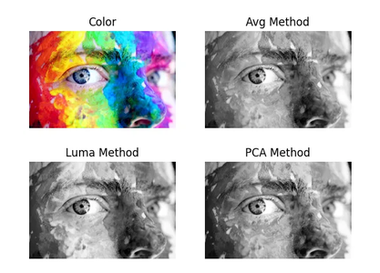

But it all begins with a deceptively simple step, grayscale conversion, and it turns out this is far more important (and nuanced) than it looks.

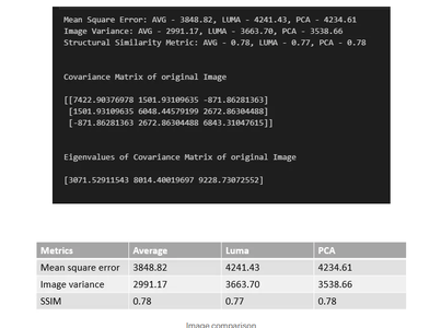

I explored and implemented three methods for grayscale conversion:
--> Equal Weighted Average
--> Luma-Weighted Average
--> Principal Component Analysis (PCA)
Each method reduces the image to a single luminance-based channel, simplifying edge detection and pixel-wise comparisons, but they do so differently. PCA, for example, finds the direction of maximum variance across RGB channels and offers better contrast. We even compared all three using MSE, variance, and SSIM metrics.
A blog on the Gray scale conversion. Check it out here- Link
Additionally, Gaussian blurring was applied to help reduce noise in the image, resulting in smoother gradients and better final outcomes.

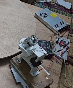

Step 3: The Drilling Module
Before we could begin threading, we needed evenly spaced anchor holes around the perimeter of the circular wooden base. To automate this, we built a custom drilling module that creates each hole accurately no manual measuring or hammering required!
Why Automate Drilling?
Placing nails or anchor holes by hand is not only tedious but also prone to error. We wanted:
- Perfect alignment with the digitally generated nail positions
- Repeatable precision
- Time savings during setup
The Mechanical Setup
Our drilling module features vertical (slanted Z-axis) movement, allowing the drill to move up and down to pierce the board. To achieve this using a rotating motor, we implemented a lead screw mechanism.
How It Works:
- A drill carriage (holding the drilling tool) is mounted on a nut that rides along the screw.
- As the motor rotates the lead screw, the nut moves up or down converting rotational motion into linear motion.
This setup works with
- Smooth and accurate vertical travel
- High-precision servo motor
- Load-bearing ability to support the drill's weight
Control:
- The base rotates to the desired angle using the setup from Step 2.
- The drill module lowers using the lead screw mechanism.
- The drill spins and creates a hole at that position.
- The module retracts back up and rotates to the next index.
This cycle is repeated for all anchor points, giving us perfectly placed holes for threading.

Step 5: Electronics & Control System
The mechanical parts are only half the story the precision and automation of our string art machine are powered by a carefully designed electronics setup, all orchestrated by the ESP32 microcontroller.
Our system operates in two main phases, each requiring coordinated motor control and timing:
Phase 1: Drilling Automation
During this phase, the base plate and drill module work in perfect sync:
- The ESP32 commands the base plate (driven by a stepper motor) to rotate to the desired hole position.
- The servo motor lowers the drill head onto the wooden board.
- The drilling motor, powered by a 12V supply, engages and creates a clean hole.
- The servo retracts the drill head.
- The base plate rotates to the next anchor position and the cycle repeats until all holes are drilled.
Power & Control Details:
- Drill Motor: Powered using a 12V supply regulated via a buck converter from a 20V SMPS.
- Servo (Z-axis): Lowers and raises the drill, connected to the ESP32 PWM pins.
- Base Stepper Motor: Controlled via a DRV8825 motor driver, using STEP and DIR pins from the ESP32 for precise angular control.
