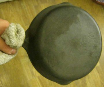

Once this is done, the pan should look "brown" because the oil isn't completely polymerized. To completely polymerize it, the temperature needs to be heated even hotter on the burner. To complete the post seasoning, do the following:
- Put the pan on the burner on "HI"
- Apply a think layer of oil to the inside of the pan while hot / burning
- When the oil smokes, repeat [2] another 2-5 times (this takes < 20 seconds per application)
- Reduce from "HI" to medium in steps and repeat [3]
- Reduce from medium to low in steps and repeat [3]
- Return to "HI" and keep there until smoking stops
When this is complete, you have a slick seasoned surface.
