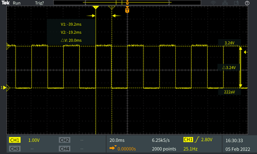

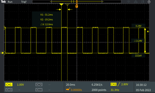

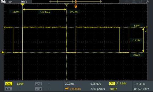

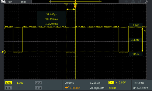

For diagnostic purposes when the strobe is disabled the on and off times can be verified with an oscilloscope attached to the A1 pin.
The A1 output is disabled when the strobe is enabled.

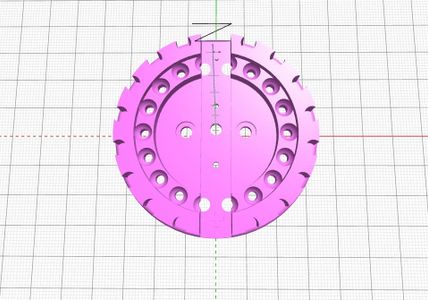

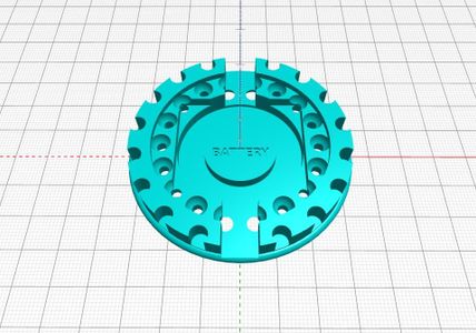

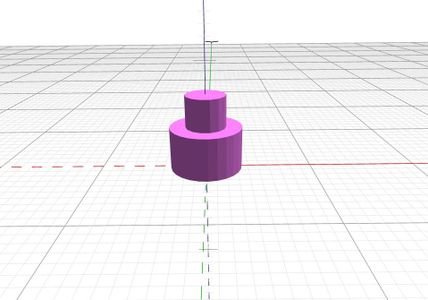

The CPB (Circuit Playground Bluefruit), was housed in a 3D printed PETG case.
A translucent case containing the CPB and the battery.
Four bolts which pass through both halves of the body are used to clamp everything together.
This was designed using BlocksCAD.
However, it would work equally well without it, if the battery is supported in the palm of the hand although a case helps to keep everything together.
Step 4: Diagnostic Output
Oscilloscope images at the A1 reference output for different pulse durations (4, 10, 20 & 90)mS and the loop delay time.
