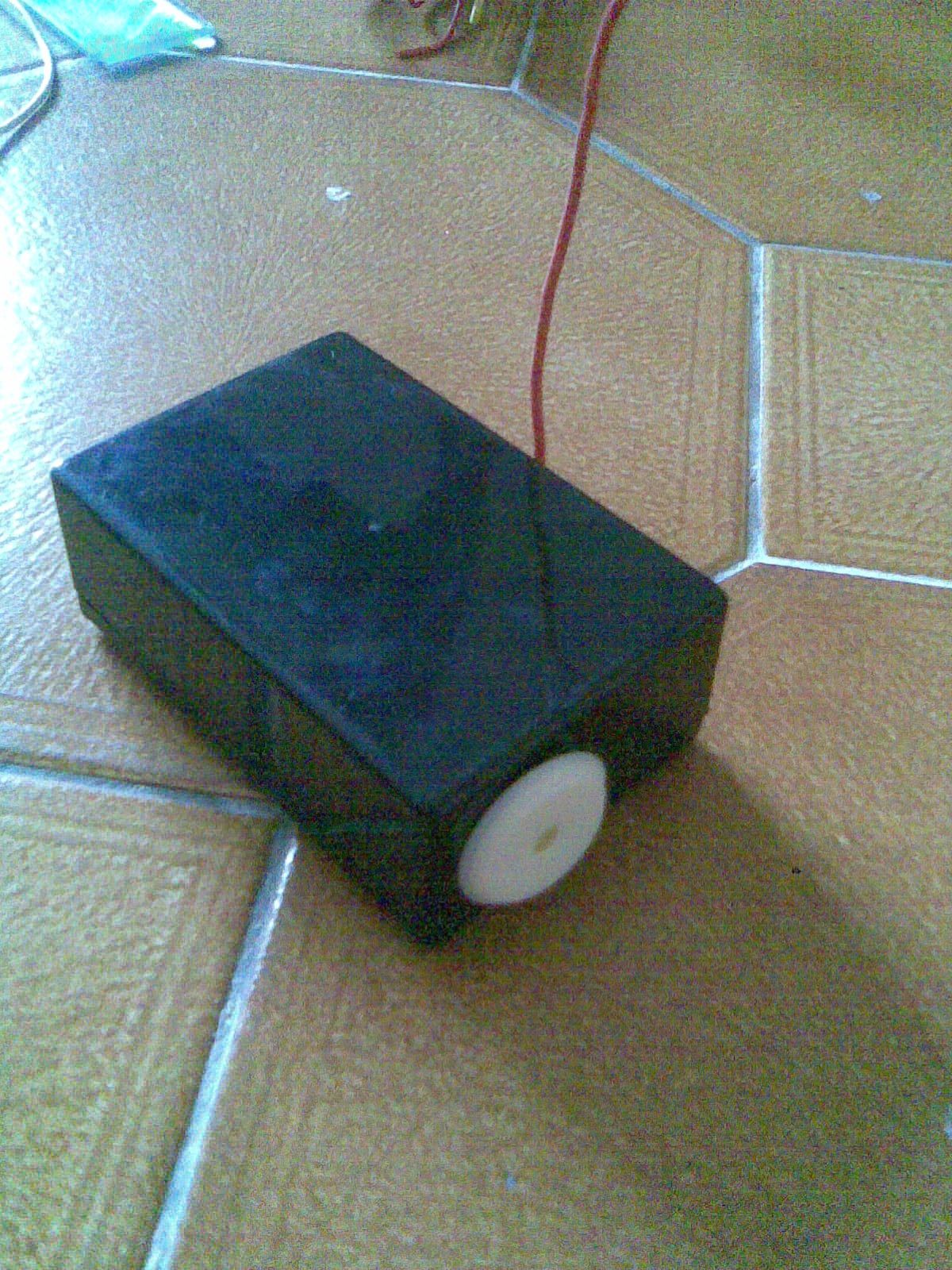

The enclosure is plastic with two aluminium panels and some ventilation fissures. The LEDs are mounted on the front panel with some heatsink compound from Dealextreme. On the back panel I put an ATX Molex connector and the RS232 connector. The back panel is also used as heatsink for the BC337s.
I also put a 12V fan that sucks air from inside to outside. This lowers the internal pressure and fresh air is sucked from the ventilation fissures. This approach is much better than just blowing air into the enclosure.
Then I placed some adhesive buffers on the bottom.

Step 10: The Final Result
Here's a video and some photos of the finished thing.
It looks good :)
