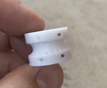

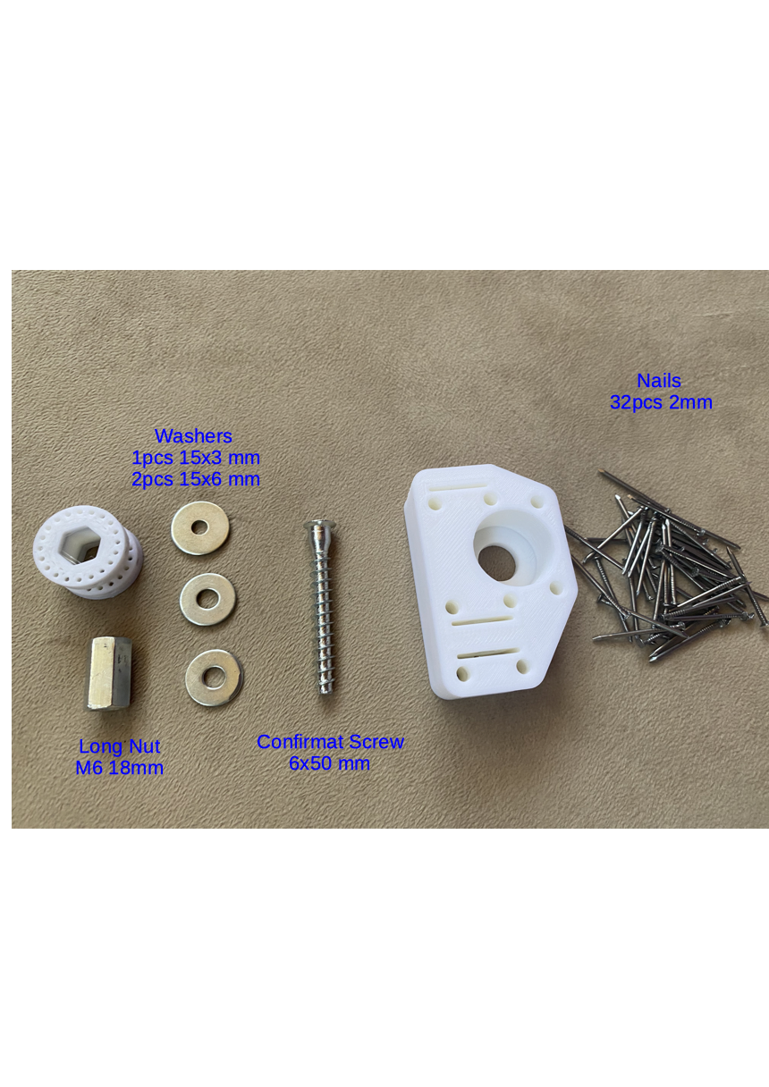

Strong Worm Gear 1:20 with metal worm and metal reinforcements.
  • Confirmat Screw 6x50 mm
  • Washers
  • 1 pcs D outer 15mm, D inner 3 mm
  • 2 pcs D outer 15mm, D inner 6 mm
  • Nails 32 pcs D 2 mm, length at least 20mm
  • Long Nut M6
  • Plastic PLA/PETG/ABS... ~ 50g
  • Lubricant

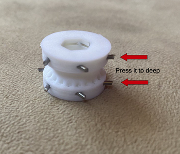

In order to make the wheel stronger, you can reinforce it with nails.
Cut off 12 nail tails in 5-6 mm length and put them into special slots inside the wheel.

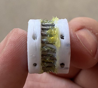

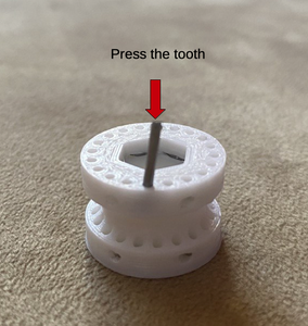

Step 3: Gear Teeth
Nails are used as gear teeth. Teeth hook the worm and rotate the wheel.

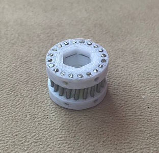

Prepare 20 nail shanks in 12-13 mm without tips.
Insert all teeth into the wheel.

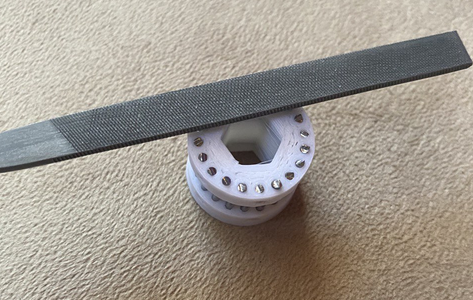

Use a file to avoid burrs on the teeth.

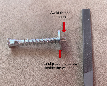

Step 4: Prepare the Worm
Confirmat screw is used as a worm. The tail of the screw has to be round (without thread) to be placed inside a washer 15x3 mm. Use a file to avoid thread on the screw tail.

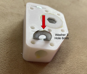

Step 5: Assembly
  1. Put washers 1 and 2 into the box
  2. Lubricate the wheel
  3. Insert the wheel
  4. Lubricate the confirmat screew
  5. Screw the confirmat in
  6. Put the washer 3 into the box

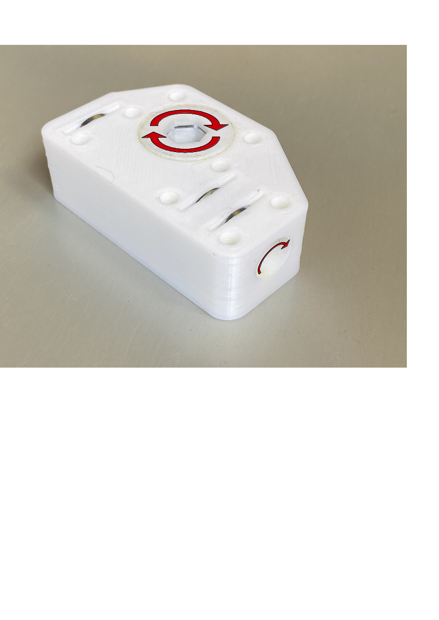

Step 6: Test
Here you can see my test of the gearbox by my screwdriver.
