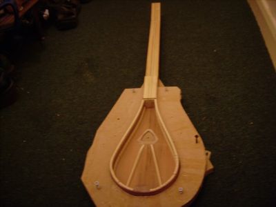

I have drawn out the plan onto 3 sheets of A4
Step 2:
I made a mold out of MDF off-cuts.
The side was bent using a pipe and blow lamp.
The tail block was shaped and glued on.
I made the kerfed lining from the beading.
The arrow points to a small piece of veneer which will end up
giving me a slight neck angle.
Step 3:
I made the neck then cut and glued the scarf joint.
The neck heel will also be the neck block.
The ribs will be glued to the sides of the block/heel.
I forgot to take a pic.

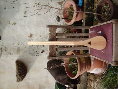

I joined the soundboard.
The top is 2mm +/- 0.1mm.
Soundhole is cut out and the patch glued on.
Braces are glued on and rough shaped.

The fretboard is glued on and most of
the neck shaping is done.
Reflection on some of the frets makes them
look a bit skew-whiff but they are parallel
with each other.
